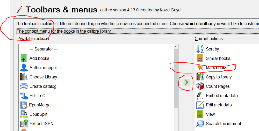

Old 04-19-2020, 09:10 AM   #175
Posts: 31,606
Karma: 64144480
Ah! That is not a Default Menu item
Preferences: Toolbars and Menus: CONTEXT MENU (when device not connected).
See Image (other names/positions will vary )
find Mark on the left: use the Arrow to make it move to the Right: <you can position it (or any other) up or down using the Green Arrows on the far Right>. Remember to APPLY

Old 04-19-2020, 05:19 PM   #176
Posts: 22,495
Karma: 32600658
Rida's image is the Default Book list context menu.
But, your menu has been customised significantly, e.g. Embed, Mark, and optional PIs added.
