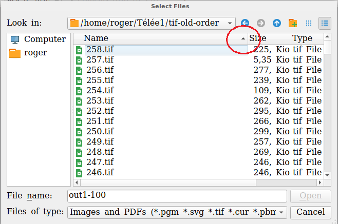

I did not find any magic button to reverse the order of the files.
I was referring to the Name arrow in the Select Files dialog box.

Thank you Doitsu. Indeed... You know me too well by now...
