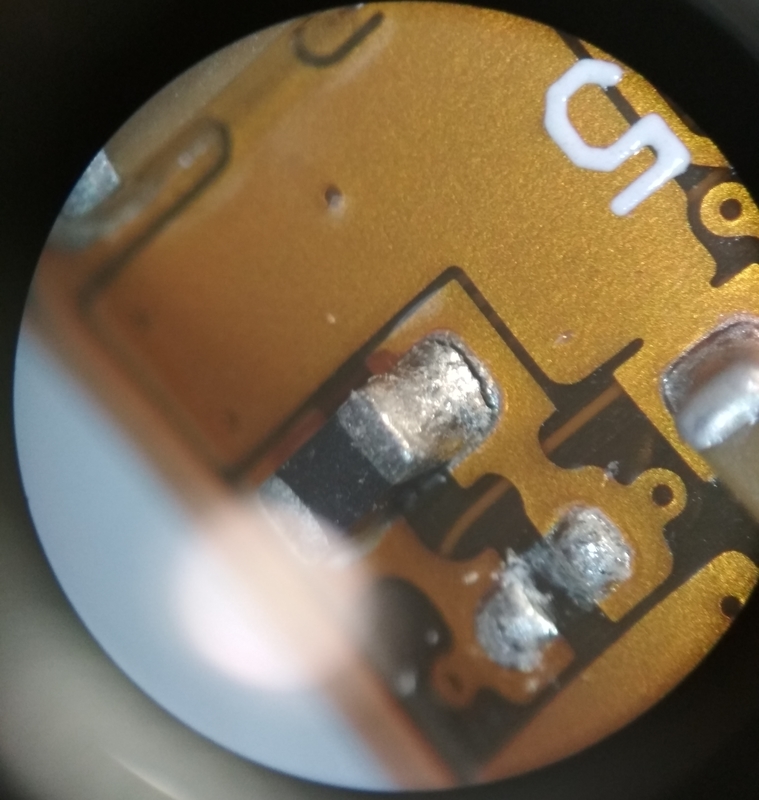

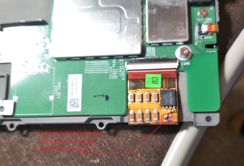

I know this is an old thread but maybe someone will be useful to what I discovered.
I had exactly the same problem as @Varu, i.e. battery error 22 after restart, and when the reader was sometimes able to start, the display worked very slowly. In the logs I found exactly the same errors regarding the lack of display temperature reading. In my case, the system set the default reading at -10 ° C (14 ° F), which I guess was the reason for the very slow operation of the display.
I found on the internet that the ED060XD4 display has a built-in 10k thermistor on pins 30-31.
When I looked at my display under the microscope, the cause of the problem appeared immediately - the temperature sensor was torn off. I don't know how it could happen because my reader was never taken apart.
After repairing the connections, everything works as it should, no errors.

That is a thermal stress crack created during the board's reflow soldering process.
I.E: Not the proper temperature curve at that point in the board.
Which also makes sense, that is near the edge of the board and your motherboard might well have been on the edge of that group of motherboards.
Translation: Shit Happens

amazing! I found a kindle pw2 in the company e-waste with this error and thought it would be a simple battery replacement to fix. I've been "hacking" on it for days and was about to give up. Saw this post and sure enough the thermistor is long gone. I didn't want to order the part and wait a week to try it out so I just soldered a regular 10k resistor (the thermistor would be 10k at about room temp) and booted right up! Unfortunately it turns out there is other damage and the touch screen no longer works. But it's super cool to see it running again!
