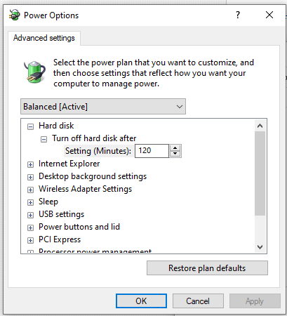

there are 2 places
1. control panel power options advanced... change when hard drive sleeps. I would set that to never and then control with method 2, below
2. each major USB drive manufacturer usually bundles some free utilities, one of those will give you access to when /if the drive powers won if idle. ( another, for my WD passport drives, controls when the light glows )
if you don't have that, google the drive manufacturer web site and see if you can find one. Or google search on something like [name and make of drive ] usb drive sleep options.
I have never hears of a USB drive that shuts down after only a minute though; I wanted the drives I use for plex media server to go dark/quiet as soon as there was nothing streaming. but the shortest setting I could get with both toshiba and WD was 10 minutes
if #2 is no good, then maybe set a value with method 1, but I think that windows applies the same setting to all drives. Before I switched to SSD, I wanted my C drive to be always on, otherwise there is a noticable delay when a spinning drive has to spin up + I read that parking/sleeping the drive many times a day is more wear and tear than using always on.
PS also in power options, there's a setting for whether windows can suspend USB ports that are idle. dunno if that affects drives, but turn that off also, for good measure if you like

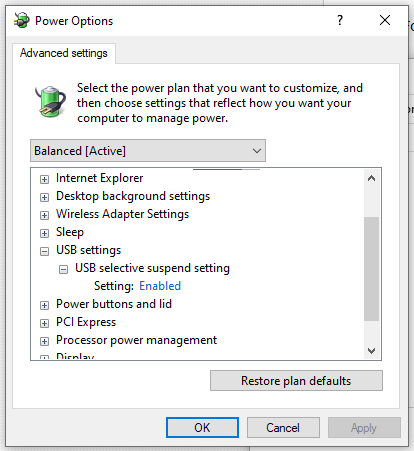

2 Places could affect this:
1) (optional) USB port Power Options: (device manager: USB port properties. good luck figuring out which one )
2) Opt Drive utilities (if installed) may have power
3) Power options: Advanced: (see images)
Another thing: Avoid using (multiple) High data volume devices on the same USB Hub. HD, Video are data intensive. Mouse and Keyboard are the slowest.
everything else is someplace in between.

another reason for never putting USB HD on a hub is power draw. a USB 2 port only delivers 0.5amp and a hard drive can take up to 0.49 . so it will not share well
give it its own port
USB3 drive in a USB3 port will be far better anyway ( does anyone still buy usb2 drives ? )
I have never used a USB3 hub so no comment on those
usb3 drive in usb2 port may call for more power than port can supply..
