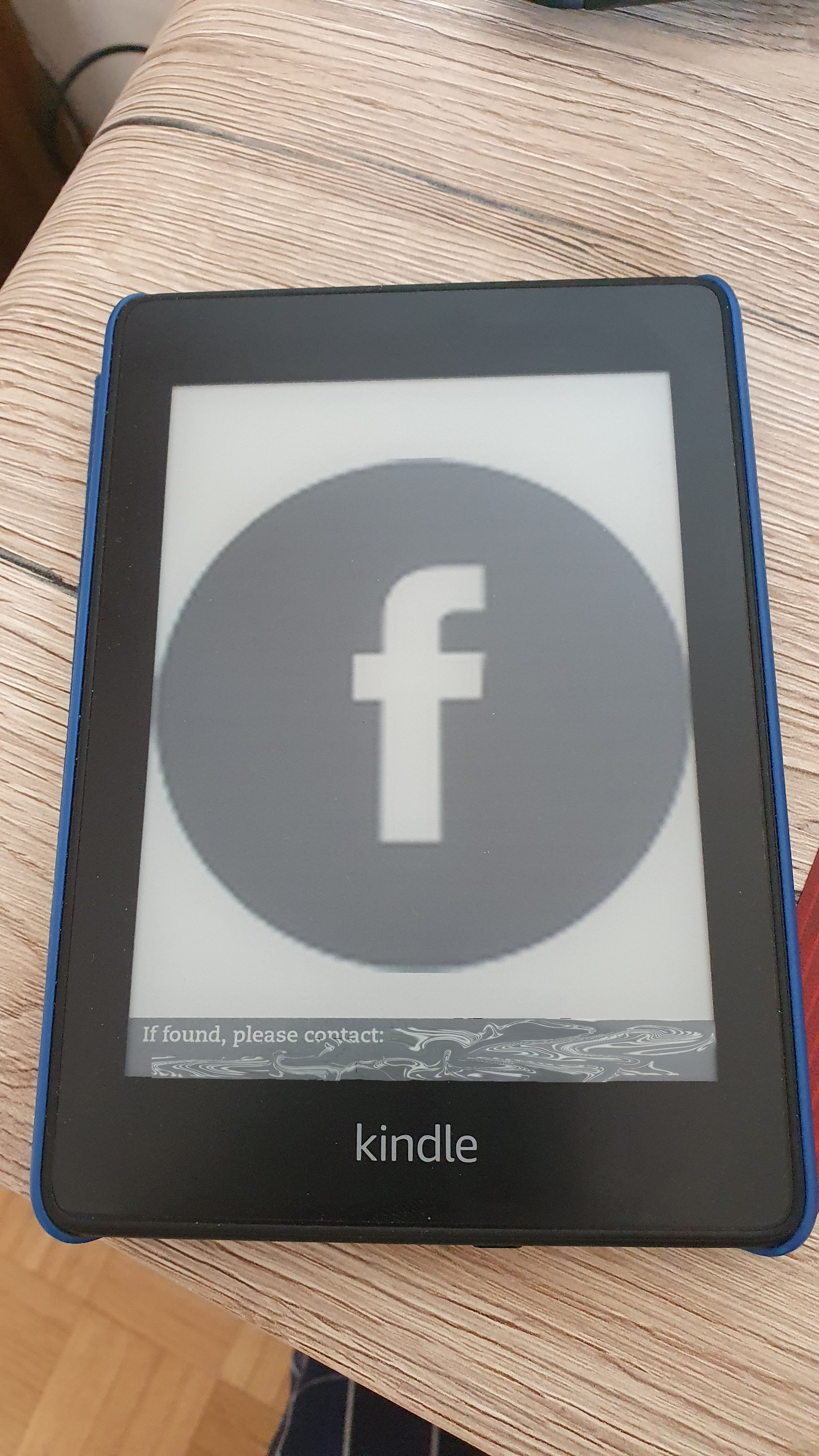

Uhm... I am rather thinking to a newly introduced... bug? I don't know. I just converted another book lately, so with the newest version of the plugin... and the SS hack now is showing as cover a huuuuge, round, facebook icon. It seems it is consistently choosing the wrong image

Pretty much the same answer as before .
(KFX support is minimal, I've never actually used it, and the format is apparently still fluid, so, expect things to subtly break more and more in the future).
Yeah, what puzzles me is how can the same book give different results I honestly don't know. Oh well...

Displayed book cover on my Kindle PW3
Hi.
First of all, many thanks for this great tool. I have always been annoyed that I can't display the current book cover as a screensaver, and now I can.
But there is one thing I would like to ask, because at least with me it is reproducible. When I change a book on the Kindle, the screensaver shows me the previous book cover, no matter how long I read the book. The second time I open the book, the correct cover is displayed. Did I setup something wrong?

@SK-Reg: That usually means the date/time on your device is a bit wonky. There are a few ways to fix that (a sync, the ;setdate searchbar command, a couple of KUAL extensions).
(Or that you attempted to test this extremely early after switching to a different book).
I tested it several times and read up to 20 minutes in the new book and it didn't work. Strangely enough, it always works the second time and immediately after switching it on.
So what's your proposal? What can I try?
So to be honest, if necessary I just switch it off and on again, because then it works

I tried the ;setdate searchbar command but it didn't change anything.

You'll have to feed it relevant information for it to work (possibly an Unix timestamp, I don't recall how the frontend works, I'm only familiar with the actual setdate script).

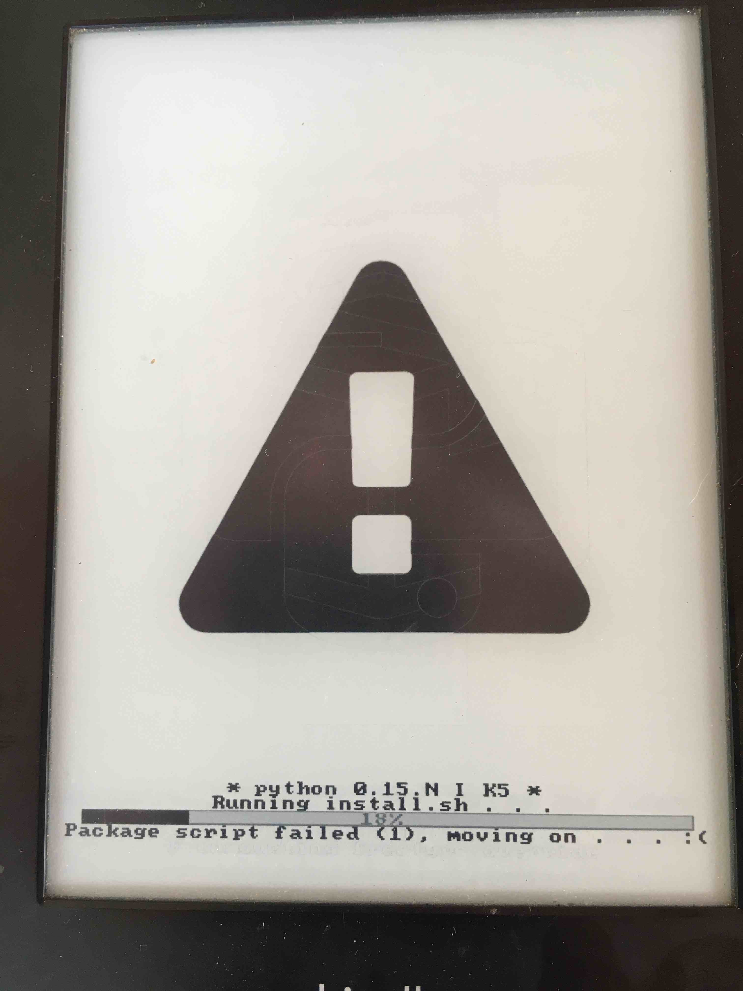

"Package script failed"
Hey guys,
I'm not sure I have any space constraints (I have 300M+ free), but I've tried to install python (Update_python_0.15.N_install_touch_pw.bin) on my Jailbroken PW1 running 5.4.4.2 with the same "Package script failed (1), moving on..." error (See attached image). I assume the Font Overrides menu isn't populating the list because of a faulty/incomplete Python install?
What should I be trying?
