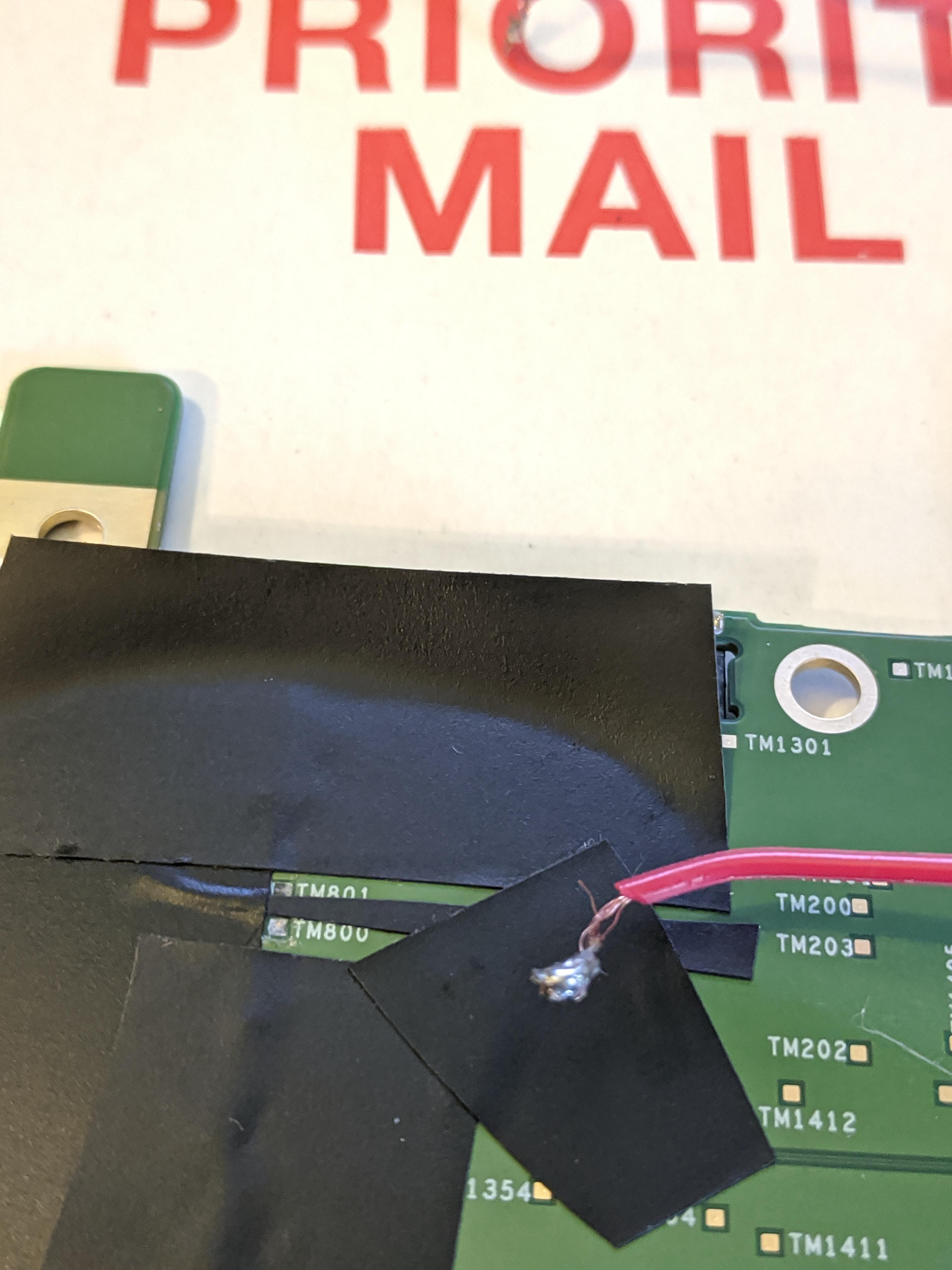

Let's gooooo. I already ripped off the front serial pads the first time I did the jailbreak and then had to use these back ones. They look nasty vulgar language deleted not sure I'll get contact with my $1 soldering iron.

Your photo is way too large. You need to remove it from the image takes and attach it.

Im terrible at soldering I can't get connection (( tried twice. Will try more again. I might need some iso alcohol to clean the contacts idk
What would be the process for restoring my device once I have serial access? Its stuck on "diag exit please use serial port" screen.

im doing some insane pcb modifications right now. Just chopping away at this green stuff. Trying to get a connection.

Originally Posted by idab420 View Post
Attachment 177954
With that type of tool(s) for doing hot soldering, you should try reading the serial port thread.
It lists at least three different ways to make the connections WITHOUT using a soldering iron.

im making solid contact, but I think I burnt out the serial pads on both sides. They're completely black with only a little copper showing. idk. Nothing happens in putty.
That MIGHT be just having the leads reversed.
Check that your connections are like:
gnd <-> gnd
Tx -> Rx
Rx <- Tx
Also be certain that you set the adapter's interface voltage to 1.8 volts, not the 3.3 or 5.0 settings.

wait I connect tx > rx?????

nevermind it was matching the diagram. TX is on the top correct?

I've confirmed I'm using the correct points. I think I've destroyed the serial connection because no matter how many times I try to resolder it on, nothing is happening in putty.
Good thing I ordered a replacement first lol
Lesson learned: dont mess with fastboot while under the influence
