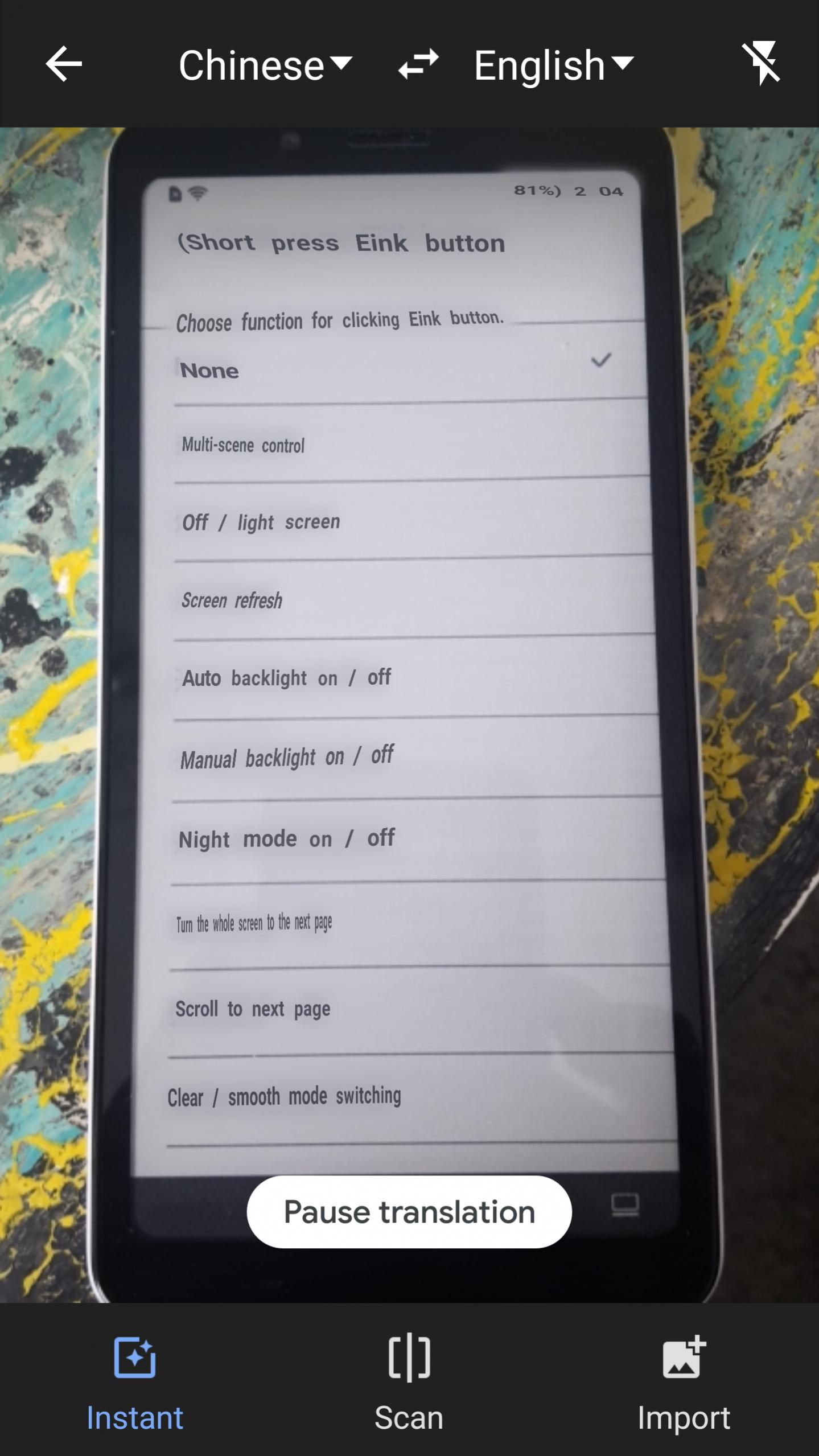

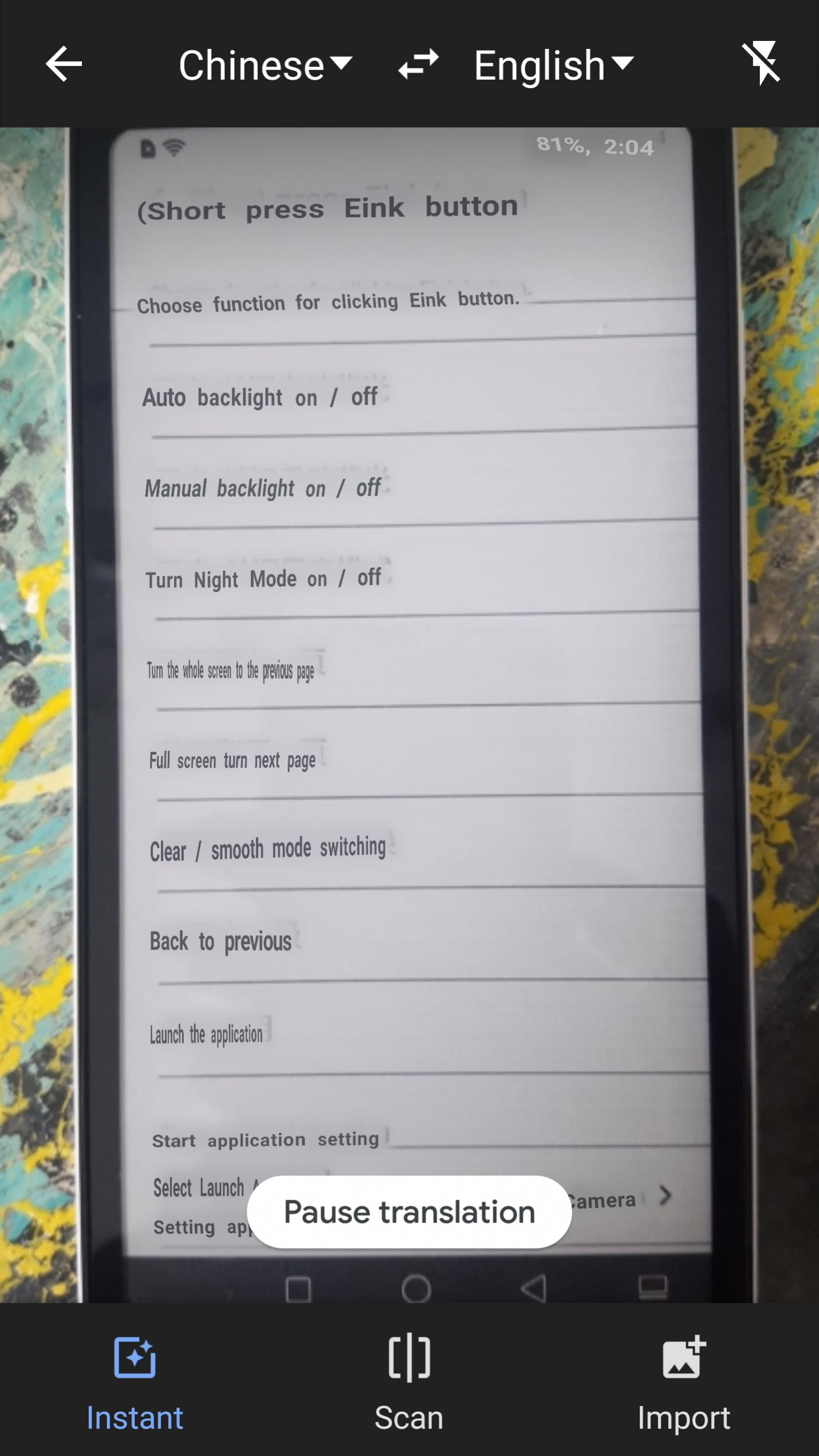

For reference, this is Google translating all the options for 'short press E ink button'.
ID:	177835   Click image for larger version
