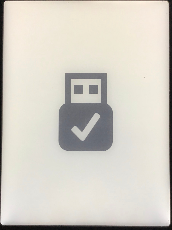

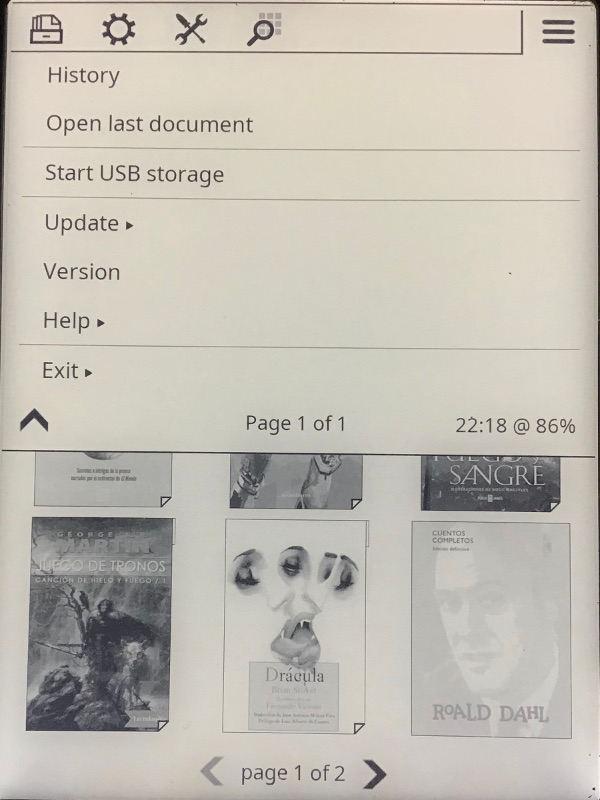

USB Mass Storage
If you installed the last version of safemode tool you will see a new menu entry on KOReader (see first image attached)
If you enter in storage mode you will see the second image. You can now connect the usb cable to your computer and do the changes you want. Once you're done you can extract your usb drive (like you do with any other USB drive on your operative system) and then press the home button to return back to KOReader.
New books will be readily available for you to read!
ID:	171958   Click image for larger version
