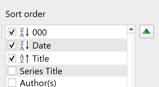

Here's a version that replaces those images with ones containing arrows lifted from Calibre's default sort.png. Version number is already bumped.
I didn't change it to use Calibre's images like most of the GUI elements because a) the size difference shows up quite noticeably, b) Calibre only has 1 sort direction icon and c) VM's arrows are backwards compared to Calibre's sort icon.
UPDATE - test version removed since BR didn't think it was an improvement.

Now, they look like blue exclamation marks - sometimes inverted :ole:
I see the 'problem', the 'arrows' are part of an image. I've never known what the 'blob' on the left of the direction column represented - I wondered if they might have been shrunken tag browser category icons IMO, if they can't be discerned, the A/Z and Z/A are redundant.
I assume White when Dark and Black when Light would just happen if unicode arrows (u2191 and u2193) were were prepended to the column names --- i.e
'↑ ' if ascending, '↓ ' if descending, or '  ' if neither
Added: And crop the arrows from the sort_xxxx.png files.
Yeah... here's the thing... My level of 'care' about this issue is rather small. I'm not interested in spending time figuring out code for adding/removing arrow characters--which I guarantee will not line up evenly on all platforms.
I'm willing to:
  1. Leave it as last posted.
  2. Strip the arrows off entirely and make it just A over Z / Z over A.
  3. Revert to the original images.
  4. Do one of the above, but with a non-transparent background.
  5. Package the plugin with images somebody else makes.
The images are 15x15--anything significantly bigger(18x18) started stretching the rows when I tried. But much larger size (128x128) don't stretch it much more.
All you need to do to try different images is replace them in the plugin zip file.
Personally, I like the original images with solid BG (mostly--I eased the corners slightly):

Posts: 22,897
Karma: 34252744
Yeah, light mode with a largish font is okay, but for me at least dark mode with a smallish font isn't. Do what you think is best for the other users.
Feel free to PM me a new version, although I suggest you leave it as it is, and wait to see what happens when version 5 comes out.
Meantime I'll hack the earlier version I was using - it does all I want. I'll look to get rid of the images, if the unicode arrows don't work out I'll use 'A'(scend) and 'D'(escend).
