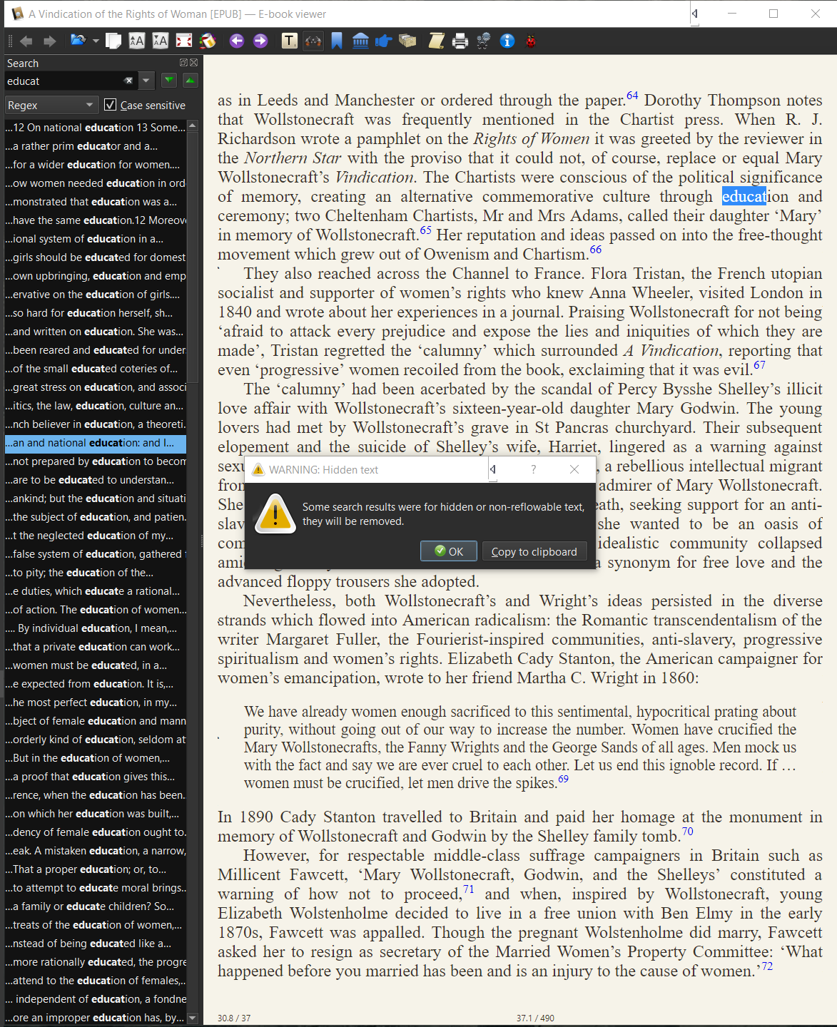

Attaching a screenshot, and book. I typed 'educat' and pressed Enter, after the list was displayed I clicked on the highlighted item.
Its possible I double clicked, but I've also had the WARNING when I've used F3/Shift+F3 to traverse the list.

Old 02-23-2020, 10:11 PM   #4
Posts: 46,608
Karma: 29634066
This will be because you have turned on regex mode, that is a bit rough, its on my todo list to improve it.
Old 02-24-2020, 01:29 AM   #5
Posts: 22,916
Karma: 34252880
Correct, it was Regex. But I'm sure I changed it back to Contains.
So I just changed it again, but it didn't seem to 'stick' if I'd already done a search. So, I started over; changed it to Contains and exited, and then did a search, as a result Contains seems to have stuck -- and most importantly I'm not getting the weird warnings.
That was simple enough - thanks.
