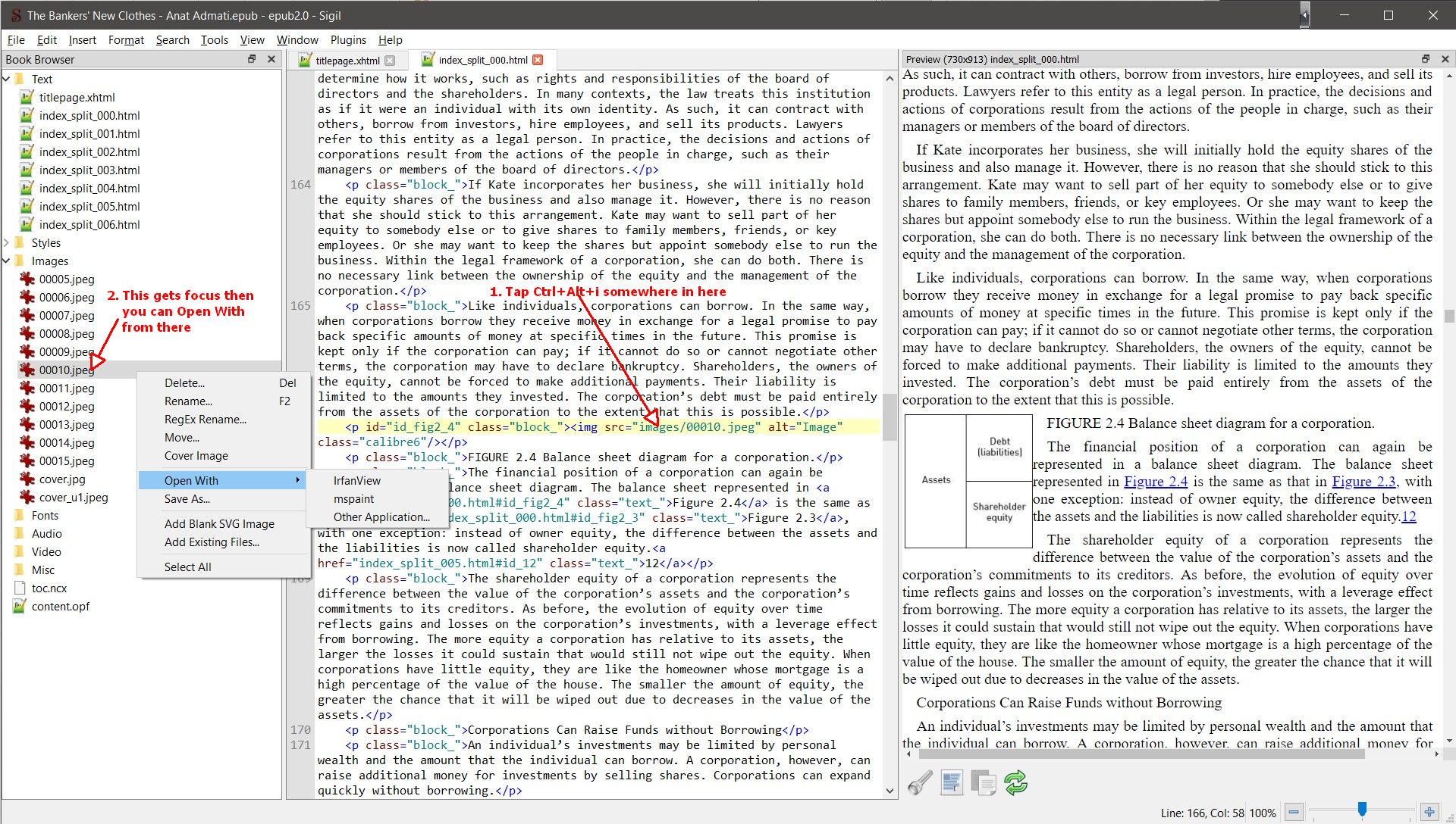

How about a keyboard shortcut to 'go to' the image in the Book Browser (e.g shift+alt+i) so that its Open With could be used.
The current implementation already handles that. You can right click in the name of an image in Code View, select "Open tab for image", the tab image becomes active, and there, you can select "Open with..."

My suggestion wouldn't open the image in a tab, which you would then have to close, it would give keyboard focus to the image file in the book browser, so you wouldn't have to find it, viz:

No idea if it would be easier than adding Open With to the CV context menu.

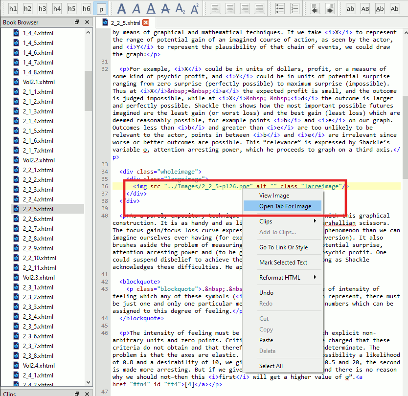

Right now Sigil can jump from the name of a style in the Code View to the style definition in the .css stylesheet. [...] In the same way, analogously, would be comfortable for the user to jump from the name of an image in the Code View to its place in the BookBrowser.
I'm scratching my head a teensy bit...
Currently, you can Right-Click the image in Code View > Open Tab for Image:

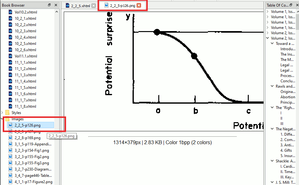

It zooms in and highlights that image in Book Browser:

(PS. Always keeping the active file highlighted + in the middle of the Book Browser is one of the reasons I prefer Sigil > Calibre. SO much easier than having to scroll through a potentially giant list.)
Attachment 177221
Attachment 177222
I think you've missed the rationale of Ruben's request.
Firstly, if you have Preview enabled, you can already see the image… in context. But, I'm not sure if he mentioned that.
Right clicking the 'image' in CV and selecting Open tab for image so you can open it with an image editor (from the image tab or the image file in the BB) is a couple of steps, and at some stage you're probably going to want to get rid of the image tab - another step. Because he edits books with a lot of images (I think he mentioned 'hundreds') Ruben wanted to avoid, either: a) having to open and close that many image tabs, or b) having to scroll up and down that many images in the Book Browser - he may keep the images collection collapsed. My suggestion of 'going to' the image in the BB was a compromise.
FWIW: I'd opt to have Open With in the right click menu of the image within Preview. I can't recall ever wanting to open an image in a Sigil or calibre editor tab, if I want to do anything with an image I'll always use the image editors I've been using for 'ever'.
