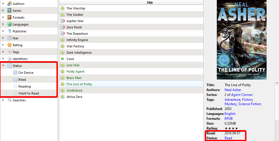

From very simple where Rating = "I've Read It" to custom columns for Read date, Status, Progress, Review. Hook in plugins like Goodreads Sync, Reading List, icons for different lists, custom color for read books, you have a very flexible setup.
Here's an idea what can be accomplished:
Thanks for the screenshot - I see you added the custom columns to the sidebar. Can you show me how you added those?
I just added two custom columns: read, finished
I can perform searches and run saved searches, but would be nice to also have it just available directly on the sidebar to quickly filter out my library to all "read" books or "not read" books, etc.
I'm guessing you made a Yes/No column for finished.
Instead, try "Comma separated, like tags, shown in tag browser", even if it's one tag, maybe you'll add want-to-read/abandoned/etc later...
For "not read", best to click twice on Read (for a Not search) instead of labeling every new book not read.
P.S. drag a book onto the sidebar to quickly mark a book "finished"... no need to go Edit Metadata, Custom Metadata then enter 'finished'.
