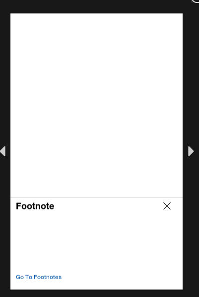

After creating epub3 and testing the epub in kindle previewer 3, all of my popup footnotes are blank and yet in kindle create they work.
1. Which is the most reliable viewer to test epub prior to submission.
2. Any suggestions as to why the notes appear blank n the popup
Here is my link
<p style="text-indent:0; line-height:2; margin-top:0; margin-right:0; margin-bottom:30; margin-left:0;">This is a test link;<a epub:type="noteref" href="#n11" style="font-family: arial; font-size: 14pt;">testing this/a></p>
and my popup footnote
<aside class="hidden" epub:type="footnote" id="n11">This is a popup note in kindle previewer 3.</aside>

Well, of course "hidden" hides it; that's what it's supposed to do.
The BEST viewer is a real device. A paperwhite, Voyage, or Oasis is pretty affordable, but that won't tell you how the Book appears on a Fire or on KCR, or anything else.
We use Kindle Previewer 3 at my shop, but we also test on real devices. There's no replacement for real devices, IME.

Well, to make it easy on you, the short answer is NOPE.
You can't hide them, at the end of the chapter or the end of the book, without hiding them in the footnote. I mean...for example, if you make a word in your footnote BOLD, at the footnote, it would be BOLD in the popup too, right, as one is the echo of the other?
