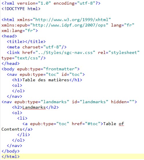

Yes, book language in metadata is french, sigil interface language is english. The option is partially working because the Table of Contents is correctly translated as <h1>Table des matières</h1>. But Landmarks (title and content) is not translated :
Edit : I see it is working for you, now I am more confused.
Indeed, there is a problem here that I did not notice during testing.
For this to work correctly, try first disable the "Table des matières" semantics for the nav.xhtml file, and then enable it again.
I think this workaround should help.
Fiou I was starting to think I was going crazy thanks, that fixed it.

Yes, each area of the nav is processed separately. Areas of the nav not involved in a particular operation will/should remain untouched. So an operation that modifies the Landmarks (such as add semantics) would be needed to see any changes in Landmarks in the nav.
Ha okay that explains it, thanks.
