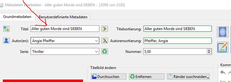

Old 02-27-2020, 04:35 AM   #1753
yaqwa
yaqwa began at the beginning.
Posts: 5
Join Date: Jan 2013
Device: kobo Glo
installed the update addon - after that this will occur. When i delete the addon all worked fine again.
After install again the same thing happened.
When i try to change something in the title of a book - means i click on the left side at a title and just want to delete a word or just a letter this will pop up

Old 02-27-2020, 10:21 PM   #1754
davidfor
Posts: 24,905
Karma: 47303828
Location: Sydney, Australia
Sorry, I have no idea how that could happen. And I would have said it was impossible. The plugin doesn't go anywhere near the metadata editor, so I can't think of how it is interacting.
But, I just had a look at the source and Kovid has checked change in to the line of code producing the error. The change will fix this problem. I'm assuming that it is a workaround for a Qt bug of some sort. That will be in the next release of calibre.
