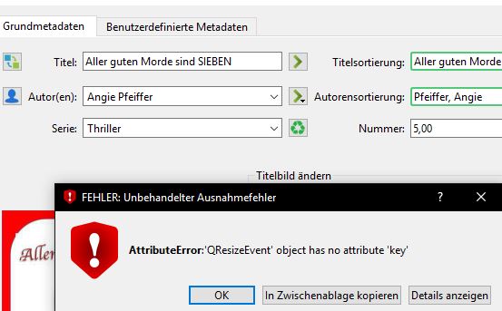

Please help - problem since last update
calibre, version 4.11.1
FEHLER: Unbehandelter Ausnahmefehler: <b>AttributeError</b>:'QResizeEvent' object has no attribute 'key'
calibre 4.11.1 [64bit] embedded-python: True is64bit: True
Windows-10-10.0.17763-SP0 Windows ('64bit', 'WindowsPE')
('Windows', '10', '10.0.17763')
Python 2.7.16+
Windows: ('10', '10.0.17763', 'SP0', u'Multiprocessor Free')
Interface language: de
Successfully initialized third party plugins: K4PC, K4Mac, Kindle Mobi and Topaz DeDRM (0, 4, 2) && Kobo Utilities (2, 10, 0) && KoboTouchExtended (3, 1, 5) && Modify ePub (1, 4, 0) && Manage Series (1, 2, 9)
File "site-packages\calibre\gui2\widgets.py", line 527, in event
AttributeError: 'QResizeEvent' object has no attribute 'key'
yaqwa is offline
Old 02-26-2020, 05:52 AM   #1752
davidfor
Posts: 24,905
Karma: 47303828
Location: Sydney, Australia
Python 2.7.16+
What were you doing when this happened? There is no indication of where in the plugin this happened. Or even that it is part of the plugin.
davidfor is offline
Old 02-27-2020, 04:35 AM   #1753
yaqwa
yaqwa began at the beginning.
Posts: 5
Join Date: Jan 2013
Device: kobo Glo
installed the update addon - after that this will occur. When i delete the addon all worked fine again.
After install again the same thing happened.
When i try to change something in the title of a book - means i click on the left side at a title and just want to delete a word or just a letter this will pop up

Old 02-27-2020, 10:21 PM   #1754
davidfor
Posts: 24,905
Karma: 47303828
Sorry, I have no idea how that could happen. And I would have said it was impossible. The plugin doesn't go anywhere near the metadata editor, so I can't think of how it is interacting.
But, I just had a look at the source and Kovid has checked change in to the line of code producing the error. The change will fix this problem. I'm assuming that it is a workaround for a Qt bug of some sort. That will be in the next release of calibre.
davidfor is offline
Old 02-29-2020, 04:38 AM   #1755
yaqwa
Posts: 5
Join Date: Jan 2013
Device: kobo Glo
4.11.2 has the same problem
yaqwa is offline
