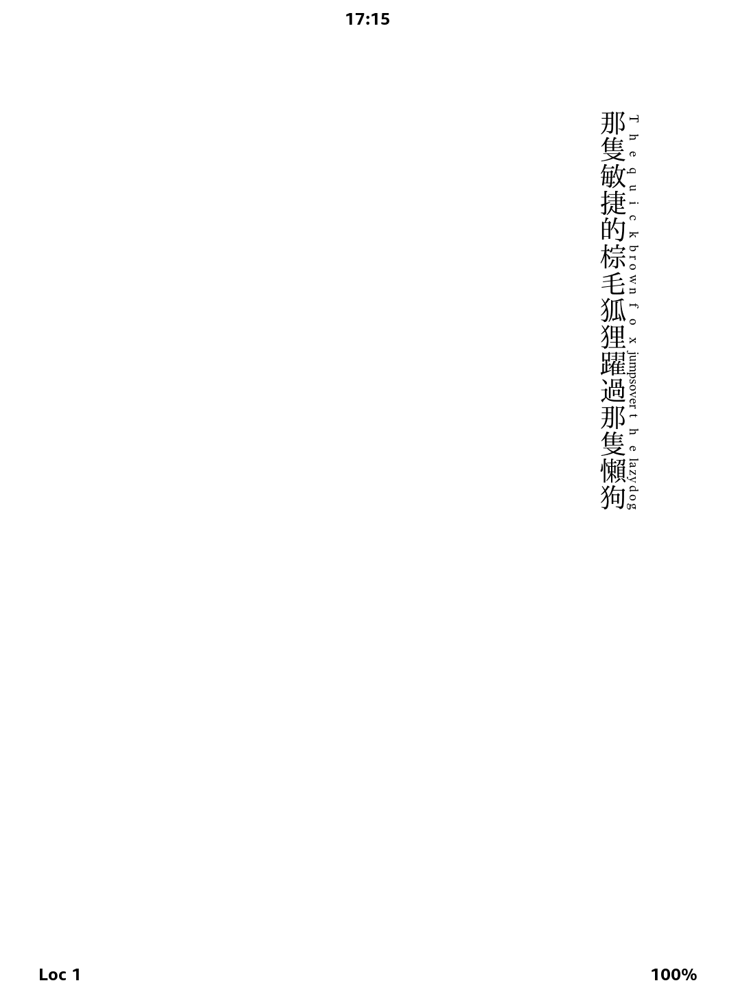

Workaround for vertical text and ruby
Hi, I would like to share a workaround from my friend, to deal with books with vertical text and/or ruby tags.
Japanese (ja) and Traditional Chinese (zh, zh-tw) books are printed vertically. They also sometimes use special HTML tags called "ruby": https://developer.mozilla.org/en-US/...L/Element/ruby
However, for some reason, Kindle Previewer only supports vertical text and ruby tags for Japanese (dc:language=ja) books. If you feed a Chinese book (dc:language=zh or dc:language=zh-tw) with vertical text to Kindle Previewer, it will simply reject it with error message: https://www.mobileread.com/forums/sh...&postcount=456
For ruby tags, Kindle Previewer fails silently if the book does not have dc:language=ja set.
Strangely, the requirement of dc:language=ja only exists in Kindle Previewer. A Chinese ePub book with vertical text and ruby tags could be converted to KF8 (.azw3) without any issues with KindleGen.
So, to support vertifical text and ruby tags in KFX, one should set xml:lang=ja even for non-Japanese books:
--- a/previewer_prep_epub.py	2020-01-18 07:55:20.000000000 +0000
+++ b/previewer_prep_epub.py	2020-02-07 02:14:33.000000000 +0000
@@ -406,6 +406,11 @@
                         lang.text = "en"
                         fixed = True
+                    if lang.text.lower().partition(" ")[0] in ["zh", "zh-tw"]:
+                        self.log.info("Changed EPUB language from '%s' to 'ja'" % lang.text)
+                        lang.text = "ja"
+                        fixed = True
                     if FIX_LANGUAGE_SUFFIX and "-" not in lang.text:
                         current_language_pattern = re.compile(re.escape(lang.text) + "(-.+)?$", re.IGNORECASE)
                         best_language_variant, best_language_count = lang.text, 0
This hack, however, will result Japanese fonts to be used for non-Japanese books. A custom font should be used to remedy this.
Could we consider add this hack (but maybe not enabled by default) to the KFX output plugin?
BTW, calibre currently does not recognize -webkit-writing-mode and -epub-writing-mode and strips these CSS during conversion. So one must use calibre-debug to run KFX Output, instead of using calibre GUI.
I have attached a sample Chinese ePub file with vertical text and ruby. After setting the language to "ja" in KFX Output plugin, it could be rendered without issues on Kindle Paperwhite 4.
wzyboy is offline   Reply With Quote
Old 02-07-2020, 01:59 PM   #748
jhowell
jhowell's Avatar
Posts: 7,394
Karma: 95902893
Location: Charlottesville, VA
Device: Kindles
I am curious regarding your interest in converting vertical Chinese books to KFX format. Why not just use KF8? Is there something that the KF8 renderer does not handle properly or that the KFX renderer does better?
I will add an experimental feature to convert vertical Chinese language books in the next KFX Output plugin release.
You will need to add <meta name="primary-writing-mode" content="vertical-rl"/> to the <metadata> section of the OPF to enable vertical text conversion. This is proprietary Amazon Kindle metadata and should be safe to add as it should be ignored by anything else.
When this is present the plugin will change the Chinese language code to Japanese for conversion and then will change it back within the KFX file produced. Doing that will allow conversion to succeed with vertical text and should also allow Chinese font selection in the resulting file.
In your example you are applying the class "vrtl" to the <html> element. It seems that calibre does not handle this properly, resulting the the class styling being lost during conversion. I have reported it as a bug to the calibre developer.
In the mean time you can work around the problem by moving the class to the <body> element instead.
The roll out of vertical Japanese in KFX is not yet complete. The Kindle for Android and iOS apps support ruby, but the current e-ink Kindle firmware (5.12.3) uses an older version of the KFX renderer which may still have bugs in ruby support.
Old 02-07-2020, 05:56 PM   #749
wzyboy
wzyboy began at the beginning.
Posts: 6
Join Date: Sep 2012
Device: Kindle Keyboard 3G, Kindle Paperwhite [1-4]
Indeed, the KF8 format has decent support for vertical text and ruby tags. However, Kindle only supports Page Flip (the feature that you see thumbnails of nine pages at the same time) for KFX files, which is useful for voluminous books. That's why I would like to convert my ePub books to KFX instead of KF8.
Thank you for adding such a feature. After some fiddling around with the OPF file, we discovered that it is <spine page-progression-direction="rtl"> that requires lang=ja. If Kindle Previewer sees page-progrssion-direction=rtl, it will forcefully set primary-writing-mode=vertical, and primary-writing-mode=veritical requires lang=ja.
So maybe we could detect the value of page-progression-direction and decide whether the plugin should patch the language code. Or we could just add a function switch and let the user decide if they want this hack.
Glad to know it is possible to change the language code back after the processing of Kindle Previewer!
Thank you for reporting the bug to the author of calibre and the workaround!
