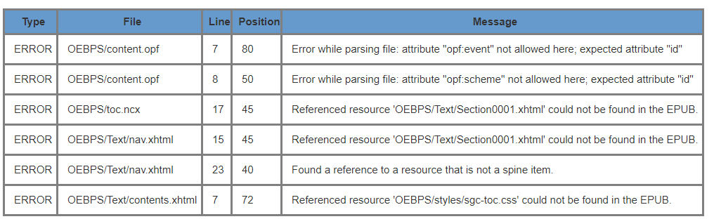

I have now recovered my epub complete, for information here are the remaining erros from the validator

If you actually use Doitsu's wonderful epubcheck plugin for Sigil, you would be able to easily click on the report rows in the Validator window and navigate directly to where the error is in Sigil.
My guess is you tried to modify your file extensions from '.htm" to '.xhtml' somehow and did not use Sigil's rename to do that and so "lost" your files. You just can not change them in the opf.
So there never was a problem in Sigil.
Please next time, answer the questions about version of Sigil or Platform as these are important.
And next time actually explain what you did (the exact sequence of events, etc). So that people can actually help.

Originally Posted by increase View Post
I have now recovered my epub complete, for information here are the remaining errors from the validator
To fix all .xhtml file extension errors, select all .htm files in the Book Browser tree, right-click them, select Rename enter .xhtml and click OK.
Also press CTRL+T, create a new TOC and then select Tools > Epub3 Tools > Generate NCX/Guide for epub2 ereaders.
This should take care of most error messages. To fix the message about the div tag, you'll have to locate it and post the code.
Make sure to create a backup copy before implementing these changes!
Thank you Doitsu, that fixed all errors except the 3-4 in the attachment
