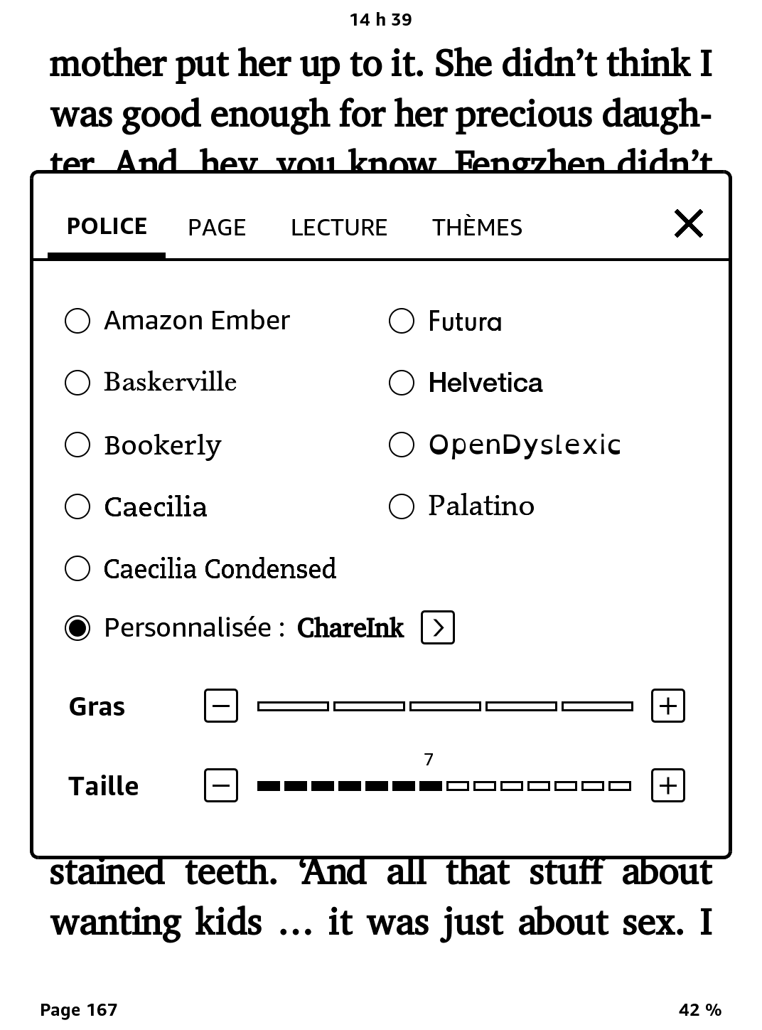

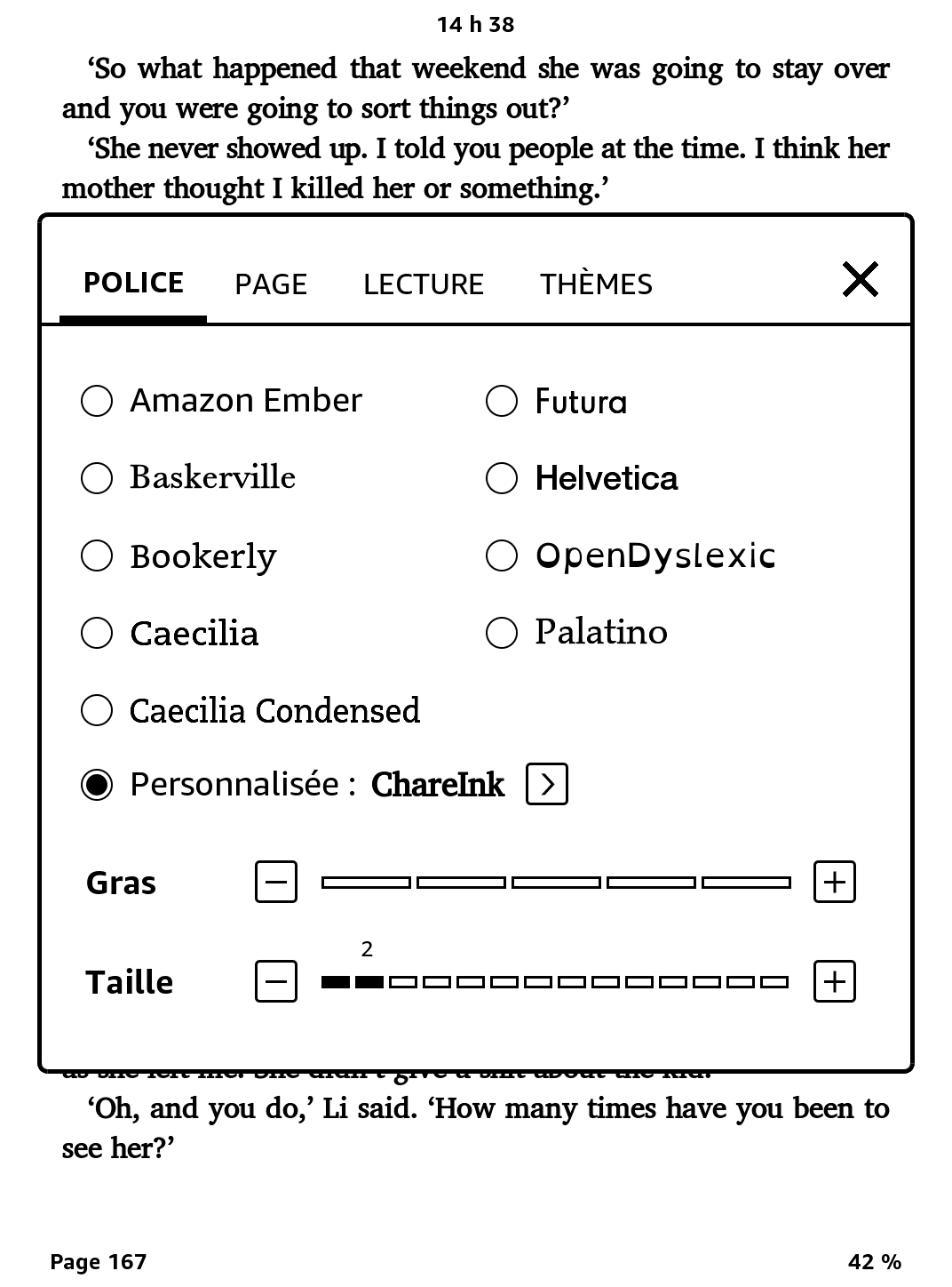

Using "ChareInk v1.1" at sizes 1 to 7:
ID:	176706Click image for larger version
ID:	176707Click image for larger version
ID:	176708Click image for larger version
ID:	176709Click image for larger version
ID:	176710Click image for larger version
ID:	176711Click image for larger version
