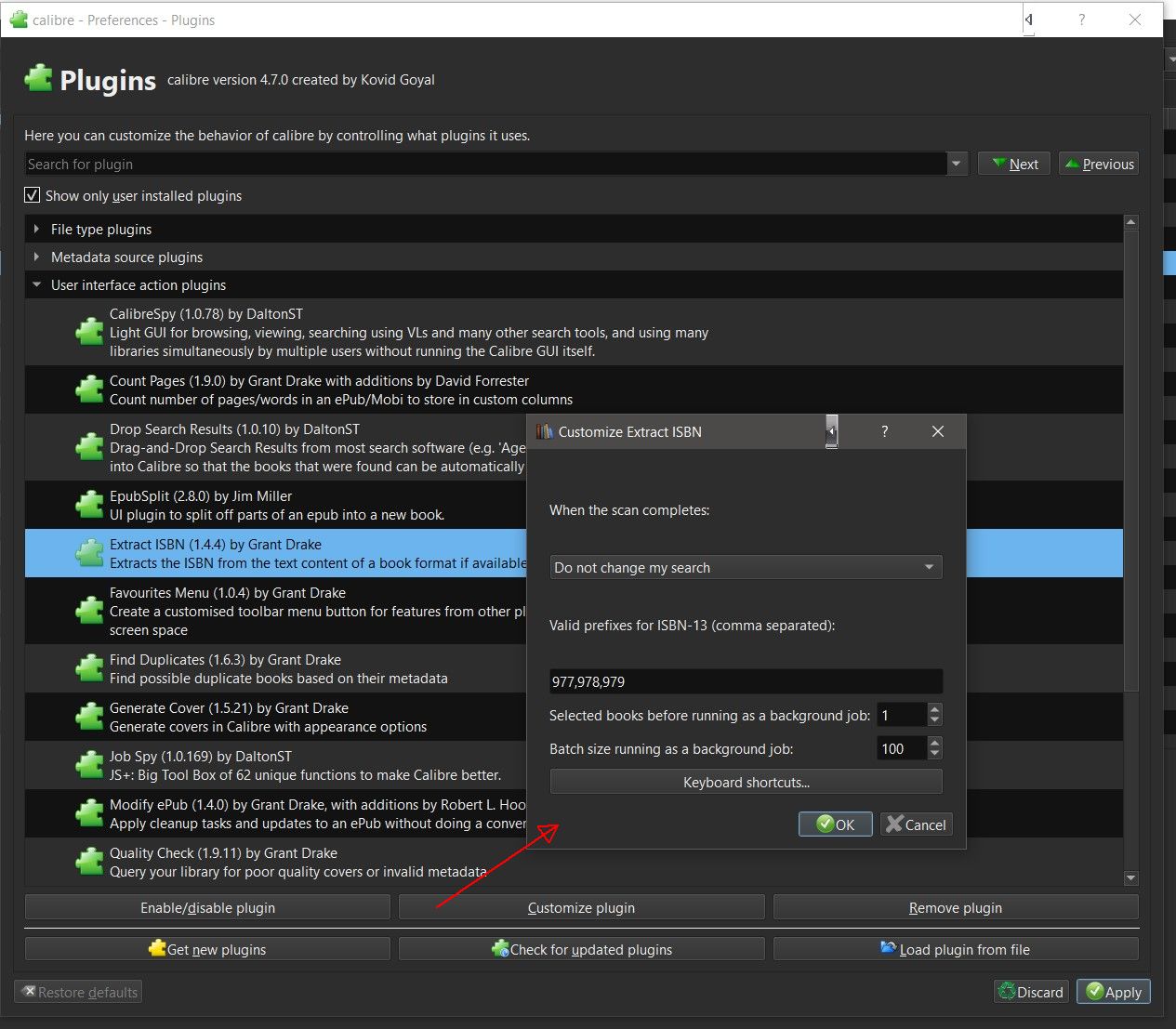

Check the plugin's settings:
Name:	Annotation 2019-12-30 071453.jpg
If in doubt about them:
  • open the calibre configuration folder in file manager (button in preference->miscellaneous)
  • close calibre,
  • open the plugins sub-folder,
  • delete the Extract ISBN.json file,
  • close the calibre configuration folder in file manager
  • restart calibre
A fresh copy of the json file will be created.
Attachment 175966
  • close calibre,
  • restart calibre
Thanks for your answer.
I did what you told me
But no changes.
