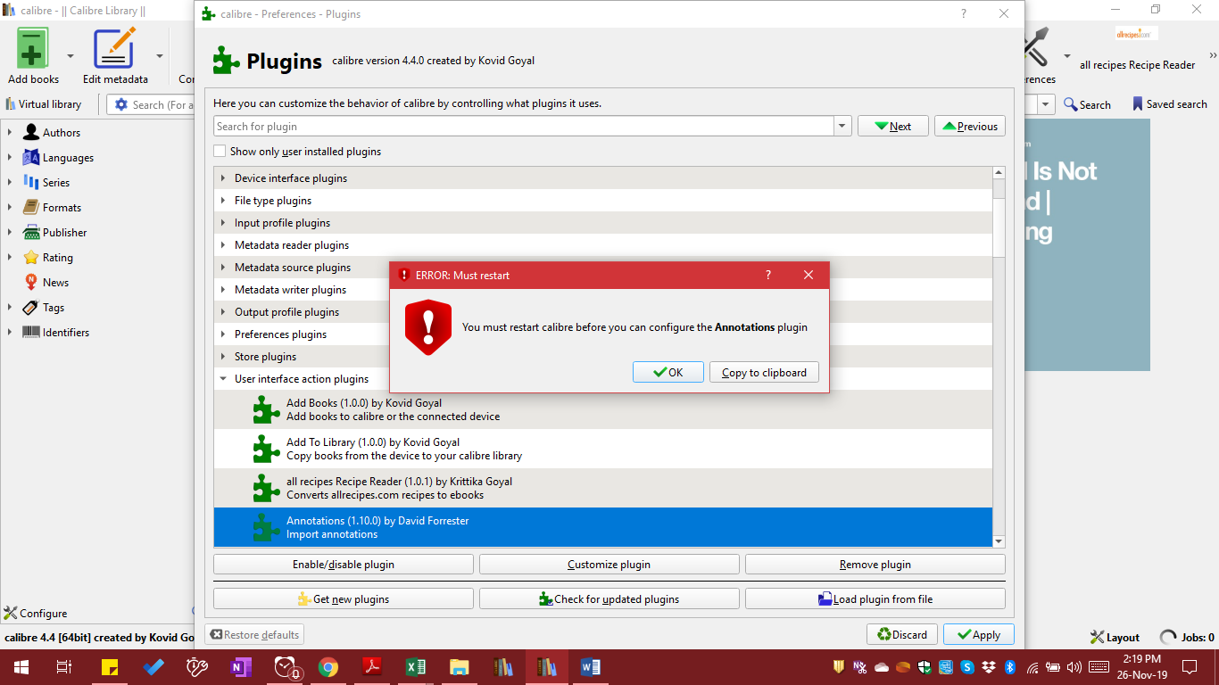

Question Trouble with Annotations Plugin Configuration
Hi
The imported annotations are added to calibre's Comments column.
However, I am unable to add them to a custom column (eg. while reading a book)
When I select Customize plugin… I keep on getting the same message..."You must restart calibre before you can configure the annotations plugin", even though i have restarted it several times. Please guide.

This is happening when you try to open the configuration dialog? If so, can you uninstall the plugin, restart and close calibre and then do the install on the next restart. After installing the plugin, you will need to restart calibre again. Then try configuring the plugin.
Thanks for the reply. But it still isn't working.
Yes, this is to customise the plugin. As you suggested, I have uninstalled the plugin, closed calibre, restarted calibre, installed the plugin, restarted... same thing same message Can see the attached image.
Name:	annotation configuration message.png
Looking at your image, you have calibre 4.4 with the Annotations plugin 1.10.0. I'd suggest looking at message #667 in this thread and trying the 1.10.2 beta attached to the message.
When I installed this plugin, it did require a restart of calibre but after that the plugin configuration dialog came up.
Good observation. Unless I here anything in the next couple of days, I'll release the update over the weekend.
