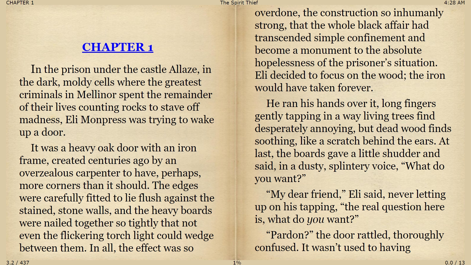

Maybe something like this (see attached)? I used the latest calibre to setup the book viewer as shown.
Yes, thanks, like that!

No special code. I described how I set things up in post 246. But I attached the adjustments I entered in Viewer - Preferences to get this look. Essentially no margins left, right or bottom. Change the color so the background and fore a different then add code in style to change the book text color back to black.
In calibre preferences I did create a Save to Disk metadata plugboard (see attached) to save the Author - Title to the title field upon using the Save to Disk feature to get the Author and title to display where only the Title would normally appear. This means I would have to use the Save to Disk feature to save the book into a reading directory before I read the book.
This was just an exercise to show what could be done with existing settings. I use the setup in post 246 myself.
