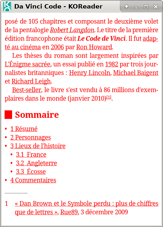

@Thlan0: I think it is not possible to modify foreground color (ie: text color). We use black and we invert colors on night mode.
The only workaround I could suggest is setting contrast/gamma to the minimum (0.3-0.6) and the light to the minimum too (0). With these settings I obtain an image which is like your first one, but my device isn't OLED
Feel free to open a new ticket on github if you wish.

If you add a styletweak /sdcard/koreader/styletweaks/font-color.css, like this:
  color:red !important;
Then it'd change the font color. However, the particular tweak I posted might be more than you bargained for. Also see the bundled Links always black/blue/bold/never bold tweaks.

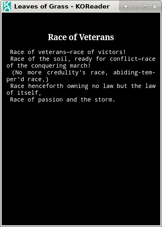

When I said "also note the night mode toggle" I meant within KOReader. Apologies for the confusion with device night mode. It inverts the colors.
