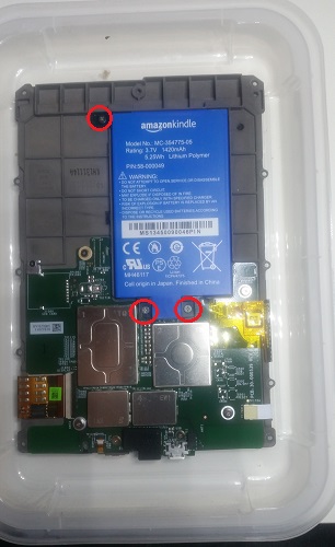

3. Remove the battery
a. Pry the silver frame (which holds the screen) out of the black back cover.
b. Flip it over and put it onto a tupperware lid so you don't get crumbs on the adhesive on the front.
c. Remove the 3 screws holding the battery and pull out the battery. Put them all in your container'o'screw-storage for safekeeping.
Play safe! It's dangerous to wield a soldering iron near lithium & live current
Attachment 143759

I have taped my USB board to the frame because my soldering skills are weak and I didn't want to risk pulling things loose as I moved it around.
Attachment 143762
