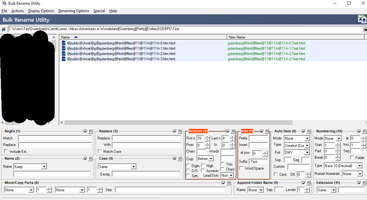

Then it could produce a list of before and after filenames side by side and have OK and CANCEL buttons.
Yes, that sounds fantastic.
Side-by-side Before/Afters would be nice.
As an example, I use Bulk Rename Utility:
and it shows any files that are being changed as green. And any options that are going to be applied with an orange box.
I think having a Default/Advanced Mode for Sigil's Bulk Rename would work.
