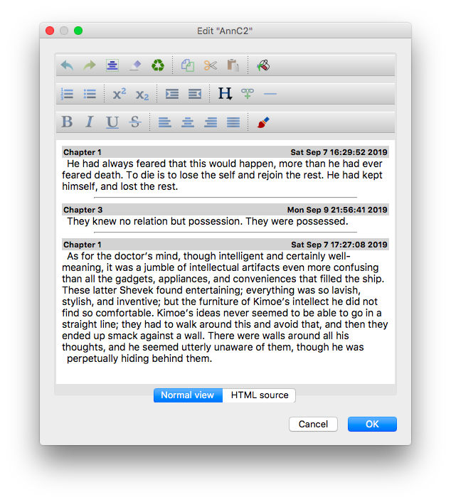

I tried the following which worked (apart from a strange issue, more on that latere): I created a new column to hold the plugin's fetched annotations and pointed the plugin to that new column. It handily offered to move existing annotations to the new column, which I accepted, a very thoughtful touch, thank you for that.
The strange this is that some of my annotations seem to be appearing out of order. For example, they appear as follows:

The annotations all seem to be there but in some cases in the wrong order. I haven't had the time to look at this more thoroughly, I'm thinking it might be an issue with the format of the new column but I can't be sure. I'll try to investigate again the following days.

How do we manually install this? I assume it has to be installed manually because you said it's a beta and also because I had a look in Calibre's own plugin page for available plugin updates and nothing came up.
Also, to continue with something I mentioned earlier. The annotations are definitely being fetched out of order. I don't know if they are being fetched out of order or if they're being saved out of order in Calibre, the end result is the same to how they appear :-)
I've created a blank, new column via the plugin's setup page to have a clean(er) test case. The annotations appear in the wrong order in the original, 'entry' column, not in the joined one.
I've attached an image to make it clear, this is how they appear right after the plugin fetched the annotations in a freshly created column. You can see both the Chapter and the date order are wrong:

What book format are you using? If these are epubs, are there is a bug that messes with the chapter and position shown in the annotations list if you close and reopen the book. There has also been a bug in recent firmware where the location isn't stored properly. But, for that bug, the annotations are not likely to be retrieved.
Can you run calibre in debug mode when you do a fetch? There should be enough information in the log to show what is happening. But, I might also need to look at the database to see the order that is there.
