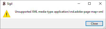

Okay, I just now pushed a fix to master to try to harden Sigilaginst unrecognized mediatypes.
I can not use the Three Men in a Boat to test it as I have added those font mimetypes so that they are now recognized.
So after the appveyor build completes, would you please grab it and test it with your 2011 epub and let me know if I have succeeded or still have more work to do.

Well ... if I rename another file within that epub, then I get the attached message. Sigil keeps working, other that the pop-up everything else works. I expect that's related to updating/changing the contents.opf?
