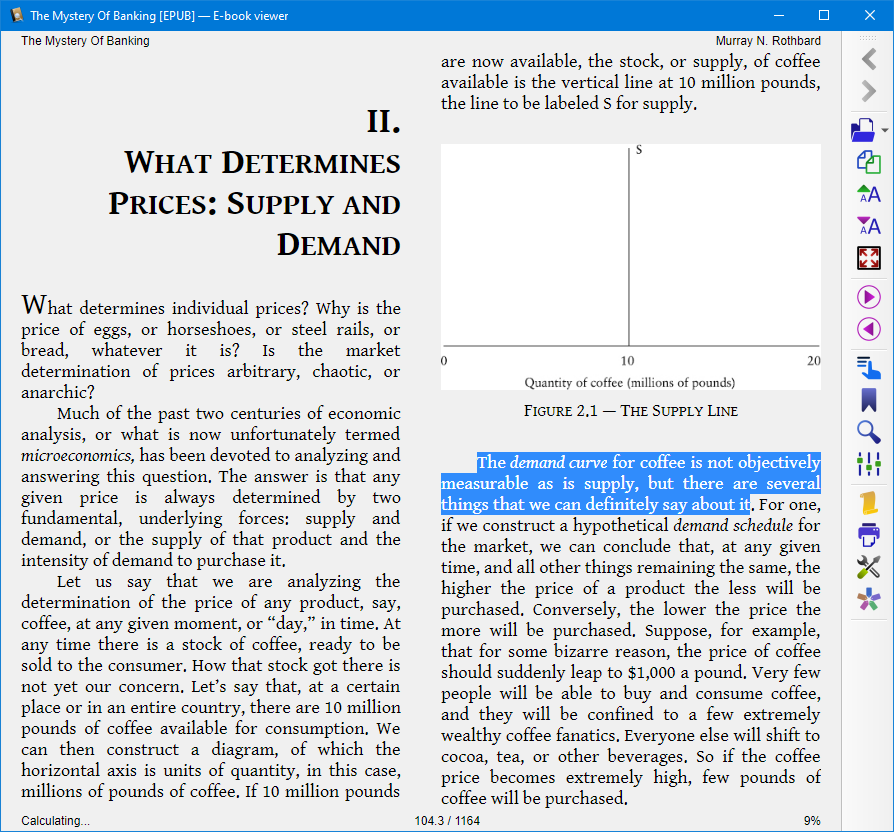

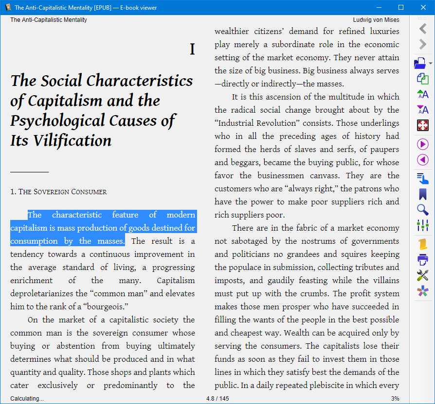

Why do different books render differently in the viewer?
Different books in my library render differently in the viewer. For example in the two attached images the font weight and line spacing are different with these two books; why is that when I have chosen the same font size in settings? I prefer the heavier weight font and tighter line spacing. Is there a way I can force all books to display the same font, font weight, line spacing, etc.? I have experimented a little with style-sheets but must not have been doing something properly because I could not affect the viewer display. Thank you.

Books have their own internal styles. You need to give your stylesheet rules enoughr priority to override those, which you can do by using !important. But in general if you want to harmonise the look and feel of books then best way to do so is via conversion.

The CSS is different enough that the font used and the line height are not the same. You can use the editor to remove any embedded fonts and line height found in the CSS. That would allow you to specify the same font and have the same line height.
