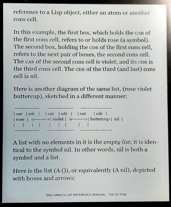

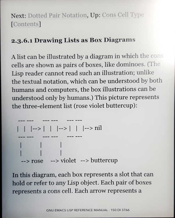

I don't understand why so much theory for a so simple fact:
Attachment 174724
Attachment 174725
I see that monospace is badly rendered; now it is formatting's fault or it is device's fault. Tertium non datur. I understand that the formatting has no problems at all. So the problem is into the device.
None of the above because it's not a rendering problem at all.
HTML and CSS are text markup languages. They tell the renderer what to make individual characters (text) look like. Which, in fact, your examples show happening correctly. They don't (and can't) tell the renderer what the whole page looks like. For this you need a page description language like PDF.
ratinox is offline   Reply With Quote

Question: "Is there something to do to solve this problem?"
Answer: HTML and CSS cannot do precise page layout. They just can't. You need to use a page description language like PDF.

Originally Posted by Sam Sahara View Post
What? What does that have to do with the thread matter?
As far as I can tell, your code is rendered perfectly. Within the bounds of the capability of the device and what you supplied. The device does not include a monospace font and there is nothing in any standards that state that it must. If you have a need for a monospace font in a book, you need to supply the font. And set it up correctly in the book.
The alternative is to change to a format that allows precise positioning, such as PDF. Or embed an image that does what you want. Possibly an SVG image would be the way to go.
How many Kobo employees are there on this forum?
This is not an official support forum for Kobo. If there are any Kobo employees here, they are not here as Kobo employees.
  1. If you look at your copies of those images, you will notice that they are not using a monospaced font. Otherwise 'violet' would look like 'violet' -- pay attention to the extra space around the 'i' and 'l' and the even spacing between the letter center lines.
  2. There is no requirement in either the epub2 or epub3 specs to have a monospaced font available.
  3. Would it be nice to have a monospaced font? Yes. Is it a bug not to have a monospaced font? No.
What? What does that have to do with the thread matter? How many Kobo employees are there on this forum?
Very much to do the post you linked to. He is attempted to align text without using a monospace font. He rejected any suggestions/workarounds with whinging that he paid "all good money" and it's a bug that his Kobo does not have a monospaced font.
As for how many Kobo employees? If any Kobo employees are reading these forums, they are not doing so as Kobo employees. Contrary to what some people seem to think, this is not an official or even unofficial, Kobo support forum.
