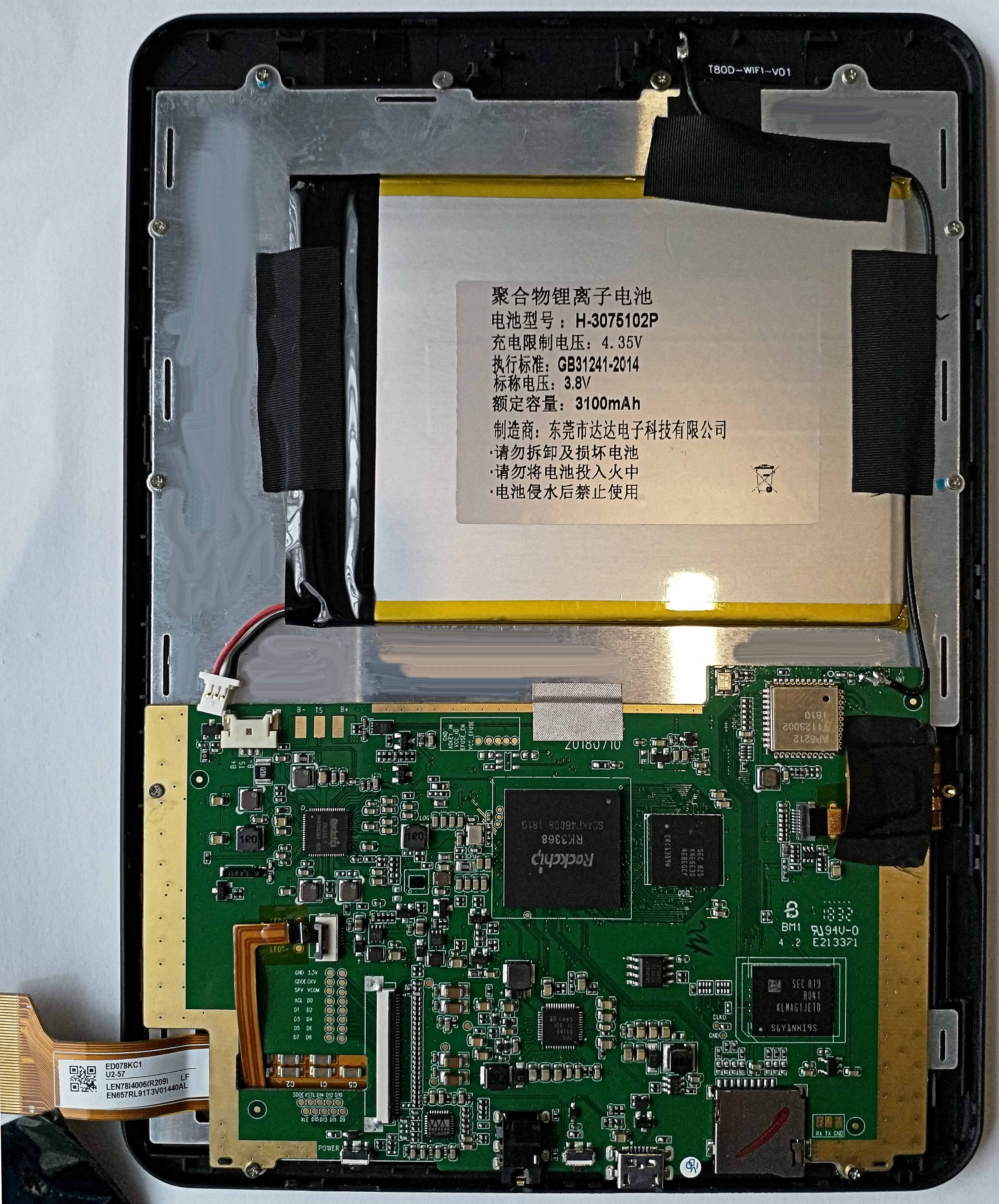

My Likebook Mars died today. Last night battery was down to ~20%. Next morning I plugged the cable in for charging. When I wanted to remove the ereader from the charger it was frozen in the Starting Up ... screen.
Long pressing the powerbutton did not fix the problem, pressing the reset button did not fix the problem, another USB cable did not fix the problem, connecting the Likebook to the PC did not fix the problem, removing the SD card did not fix the problem.
I am out of options. Did someone else experienced this problem or has any other ideas?
The Likebook is just a year old. For failing so fast it was a little bit pricey. :-(

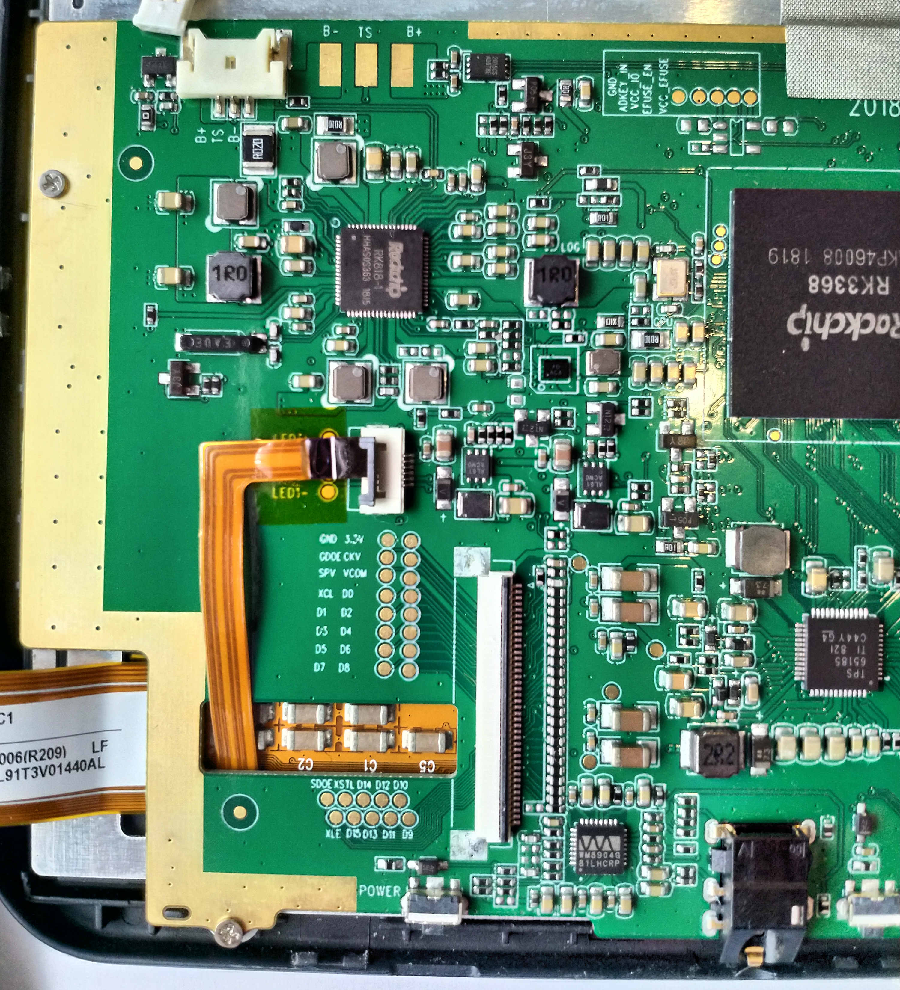

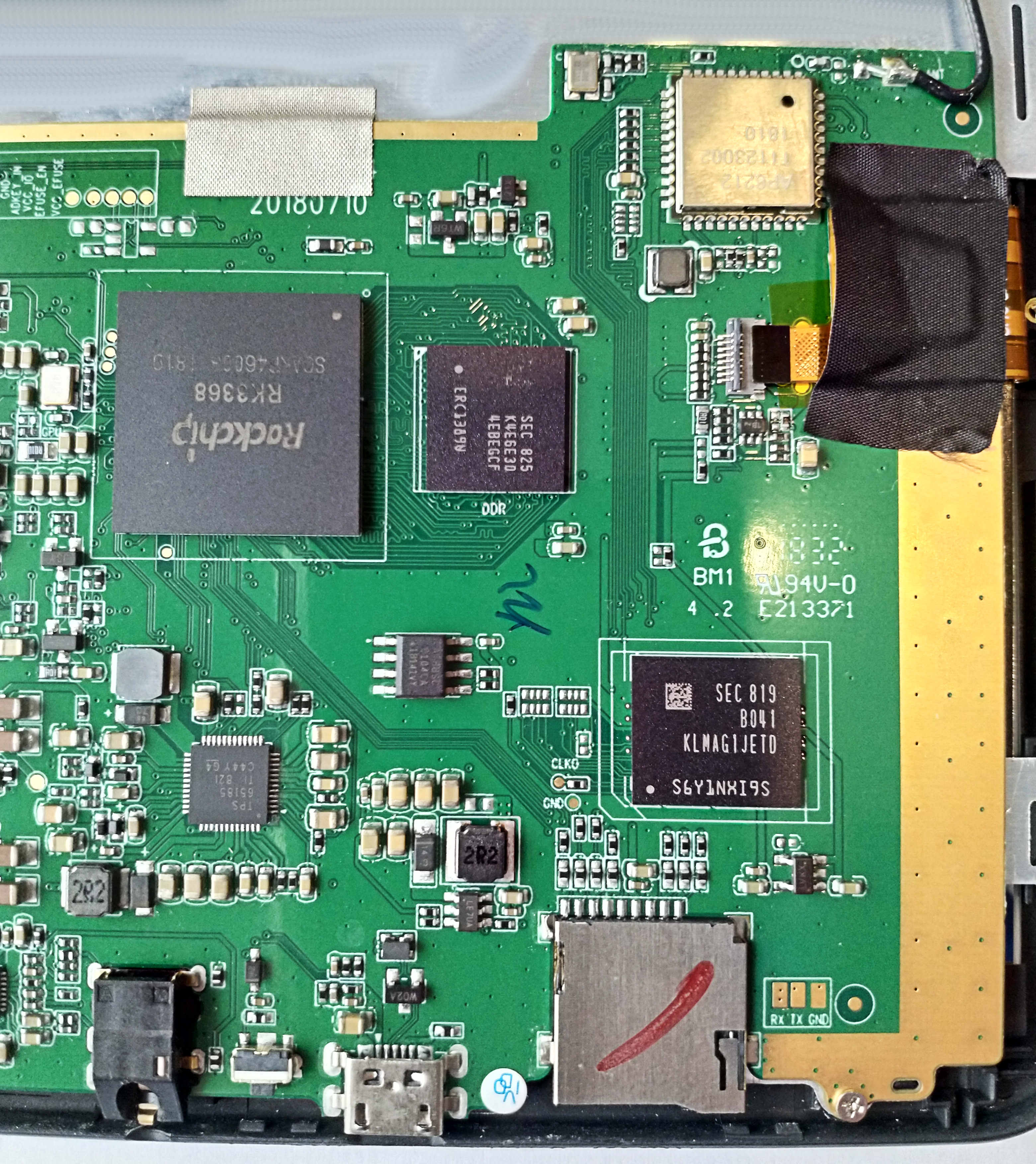

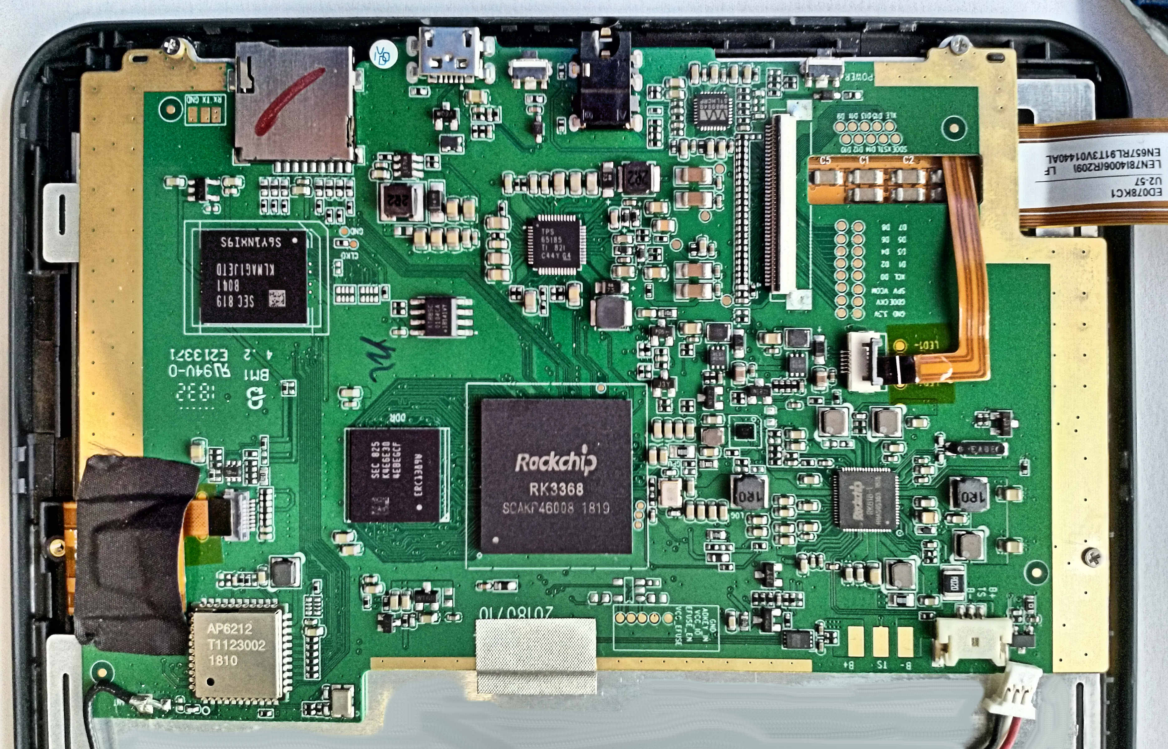

Unfortunatelly no, didn't work.
I opened the reader for unplugging the accu, hoping and so an, hoping this might help. It didn't.
Multimeter measured 3.8V, so it should be O.K., doesn't look bloated. Test points all over the board are showing some voltage.
As you can see from the pictures form the inside of the LB Mars (don't know, if there are already some pictures around in the www), the LB Mars has a very informative board layout including a debugging port.
Power switch and reset switch should be O.K. aswell, you can measure they are switching.
A little bit strange is, attached everything of there remains some mV at the test points. Voltage is draining during measuring. Measured later again there is slightly a higher mV as if there is somewhere a buffer.

Did you perhaps charge it with a fast charger?
I don't know what else could be the problem.
It would be pretty terrible if the build quality is bad enough for the tablet to die after a year of usage.

It was the same Samsung 1,55A charger I used before. But I tried out outher chargers and USB cables to make sure.
If I unplug the accu and only plug the USB cable in, I don't measure any voltage near the accu port. The USB port itself seems to be O.K., because I can measure 5V at the first SMD the VCC wire leads to.
Having a look at the pictures I provided can somebody help me to identify fuses so that i can check their passage/beep them through?
Is the board single sided? There are probably some components on the back side. I'm not seeing much at that image size, look for components marked 'F'.
No obvious corrosion, nothing looks blown but I'd suggest going over it with a magnifying glass (or microscope) and see if you can spot anything iffy
Amon_Re is offline   Reply With Quote

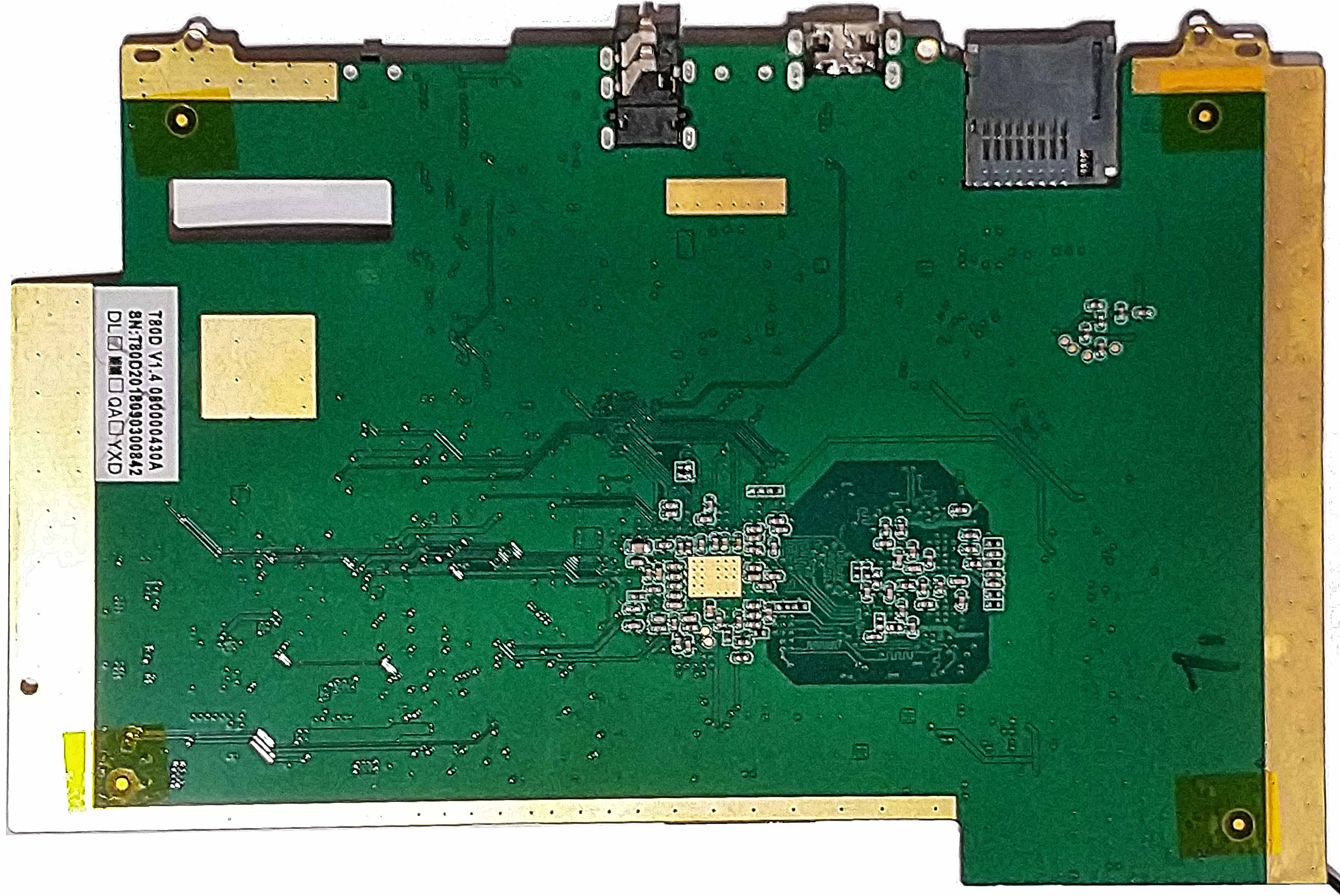

Here a picture from the back side. SMD parts become even tinier. I tried to scan it. But I had to realize my LED Office scanner has no deepfield sharpness...
But I found another solution. Fortunately, a Likebook Mars with a broken screen was auctioned on ebay on Thursday. I could bid the item very cheaply and the package was delivered today.
I replaced the boards and got a working unit again. Yippee!
To make sure I tried to enter recovery mode and bootloader mode. No problem. For drivers I used 'rkDumper_105_obc67 + debug.zip'.
The new board has a newer revision 1.5 dated 20180907, but looks the same.
