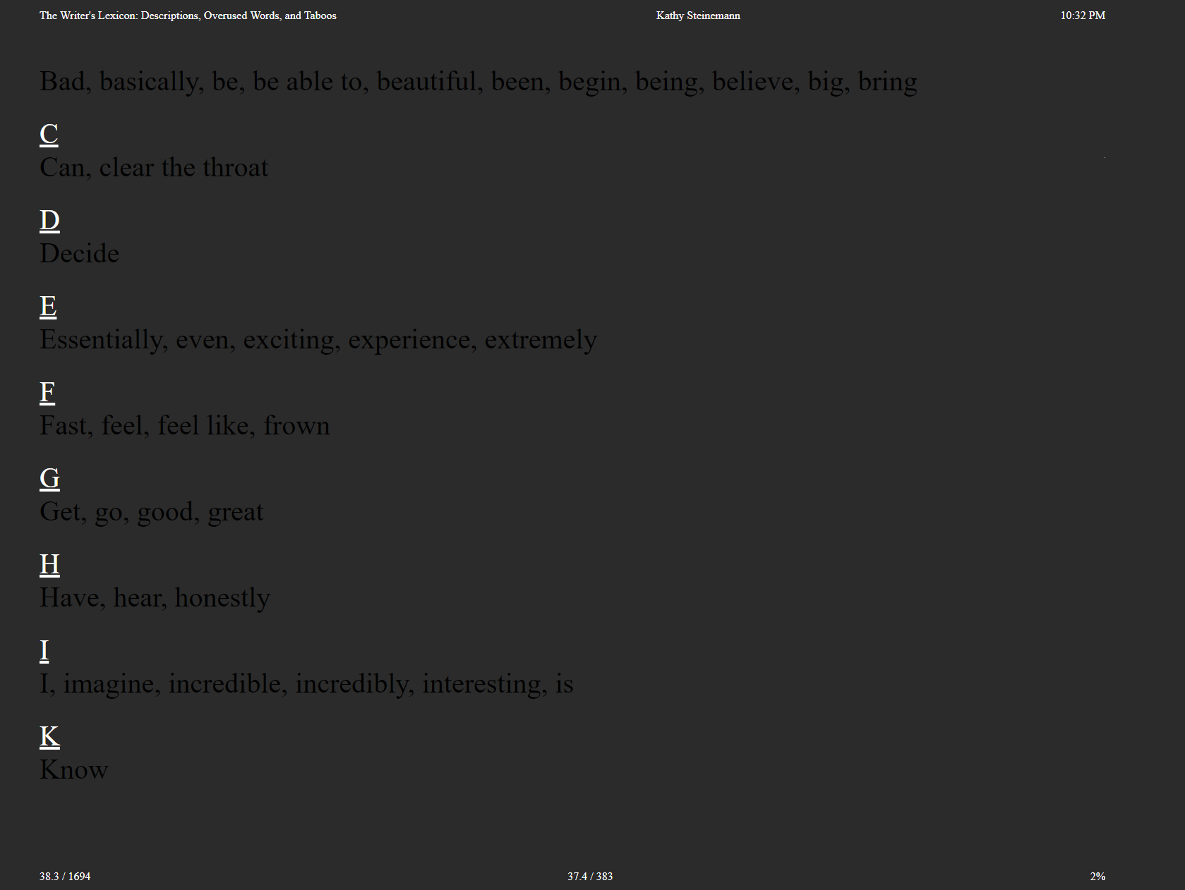

Hello, I have been trying to convert two books' dark font into white font. Is there an easy way to do this? Other books work fine--they have white font, but there's two books that have dark font that won't budge.
Here's an image to show what I mean:

I converted the book and copied * { color: white !important} into the extra css setting and while there is now some white font, it isn't every letter.
Is there something I missed or something else that I can try?
Thanks.

Didn't it give you black text on white background? I thought you wanted white text on black.
