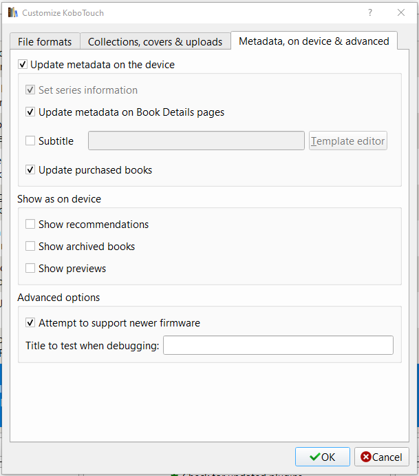

Old 10-28-2019, 05:18 PM   #6
Posts: 48,831
Karma: 174510638
Originally Posted by basati View Post
what I mean is that does not respect metadata does not create collections, it mixes everything when you upload books.
The information needed for series information, etc. are stored in the database. When you send the ebook to the device, there is no database entry. After you send the ebook and eject the ereader, the new ebooks are imported, there is now a database entry and a place to store the information. This is why you need the two connections. The second connection can update the metadata -- you can set this to happen automatically or leave it as a manual trigger. Most of the time I use automatic. See attached image.
As for collections, you might want to check the Kobo Shelves and Collections Wiki entry.
Personally, the only collection I use is a Finished collection to keep track of books finished on multiple devices. Search handles the rest of my needs.

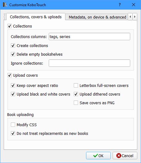

Old 10-28-2019, 07:24 PM   #7
Posts: 81,083
Karma: 150263703
What would be in your opinion the ereader device more adapted to calibre. I have a kobo and doesn't recognize metadata, doesn't make collections, doesn't make series.
Greetings
Basati
In Preferences, go to Plugins and search for KoboTouch. Once found, click the Customize button. Then set it to match the screen grab. Tags is for collections where you are not specifying a series and series is for collections for a series.
Also, you'll want to go back to Preferences and under Sending books to devices, set Metadata Management to Automatic. This way collections will be dealt with automaticalley.
