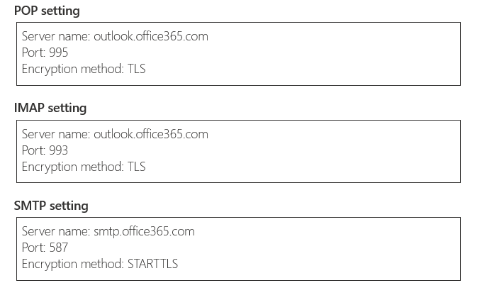

So, again, this points to my ISP being the problem. Meanwhile, can anyone share with my the outgoing settings for my Hotmail/Outlook account. I don't actually have a @hotmail.com address but I do have an @outlook.com address.
I have googled these but can't seem to find any up to date ones?

Old 10-27-2019, 04:11 PM   #44
Posts: 48,533
Karma: 174510108
A quick Google search came up the the following link: POP, IMAP, and SMTP settings for Outlook.com
Going to outlook.com and looking under Settings/Mail/Sync Email came up with the same settings. See the attached images.
