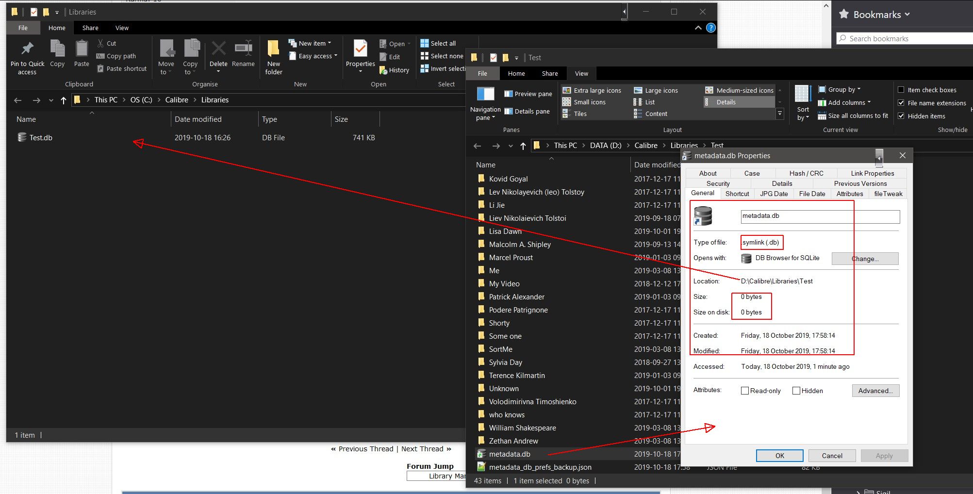

Ok I moved the db with symlinks, but the search is still slowly.
I have to search for an other solution.

Caveat - calibre reads the database into memory when a library is opened, so relocating it won't make much, if any, difference.
Are you sure the symlinks are correct, should look like this
Name:	Annotation 2019-10-18 180435.jpg
if you only have one library, move the metadata.db to the SSD and use the Environment variable

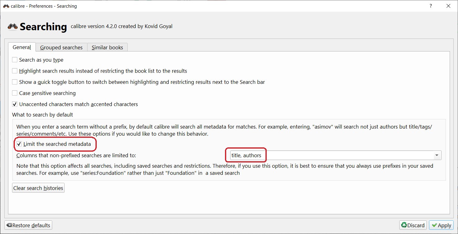

There is a setting for that so you don't have to remember to be explicit Author: name
Preferences: Searching

I already set the preferences to author and title.

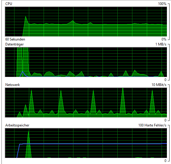

By the way. I run calibre (64bit) on Windows 10 (64) with 12 GB RAM with an AMD Phenom II X4 905e Prozessor. There are not many other programs running in the background.
The filesize of the metadata.db has 200 MB.
When I start a search the ressourcemonitor shows the following data during the search (see attachment). The searh takes about 3-4 minutes, when I not use "Author:" or "Title".
Dorian
Did you also check the "Limit the searched metadata" box? The search isn't limited to what you enter in the box until you check this option.
Name:	Search Preferences.jpg

@DoctorOhh: "...Did you also check the "Limit the searched metadata" box?..." . Yes it was already set. That reduced the time already, because first I had here also series and tags.
Also I deactivated all the plugins for test. But it had no positive effects.
