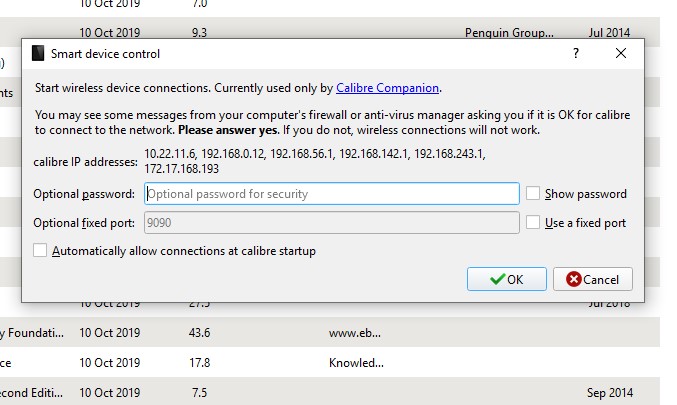

When I go to turn on the wireless connection in Calibre the dialog box shows multiple Calibre IP addresses. Is it supposed to do that?
That is not normal. It means that your pc is connected to 6 different networks. The first question is "Why do you have so many?" The second question is "Which one of them is WiFi?"
You also need to be certain that:
  • your wireless system is not running in guest mode or the device isn't connected to a guest network.
  • if your PC is running windows then that the WiFi network is configured as private
  • that your PC and device aren't connected to different WiFi bands unless your WiFi router transfers traffic between them
  • that there aren't any antivirus dregs left behind.
Section 5 of the FAQ discusses connection troubleshooting.

This will work as long as both CC and the calibre PC are on that subnet, and that the calibre PC's network interface is set to "private". My guess is that CC's auto-connect won't work because both CC and calibre can get confused about which interface to talk to.
as Chaley said, seeing multiple addresses there is strange, e.g. all I see there is a single address which i know is this PCs local LAN address 192.168.0.72
post all that you see, or a screengrab of that interface window
do you have more than one network card installed ?
Multiple IP addresses can come from VPNs (TAP, miniport, etc), multiple cabled connections, and multiple wireless adapters. There are some unusual situations where a single interface has multiple IP addresses, but this usually requires a net admin to do something explicit like set up IP aliasing.

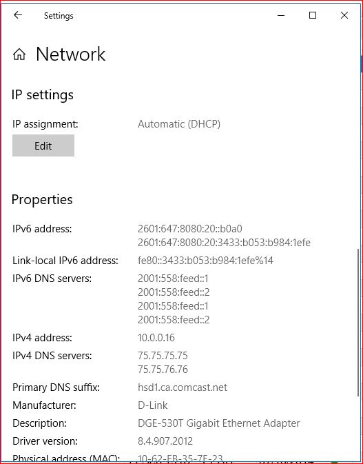

The same address as the CONTENT server needs to be used (if that is working). All that is different is the Port# (9090 is the default)
WDC connects via the local Network (in this case 192.168.0.x). It does not care where the Wifi A/P is.
IMHO Having the 'server' wired is the best , most solid, solution
OP
Open your WINDOWS Network settings: Ethernet. What do you see there under IPV4 for your Wired adapter?
