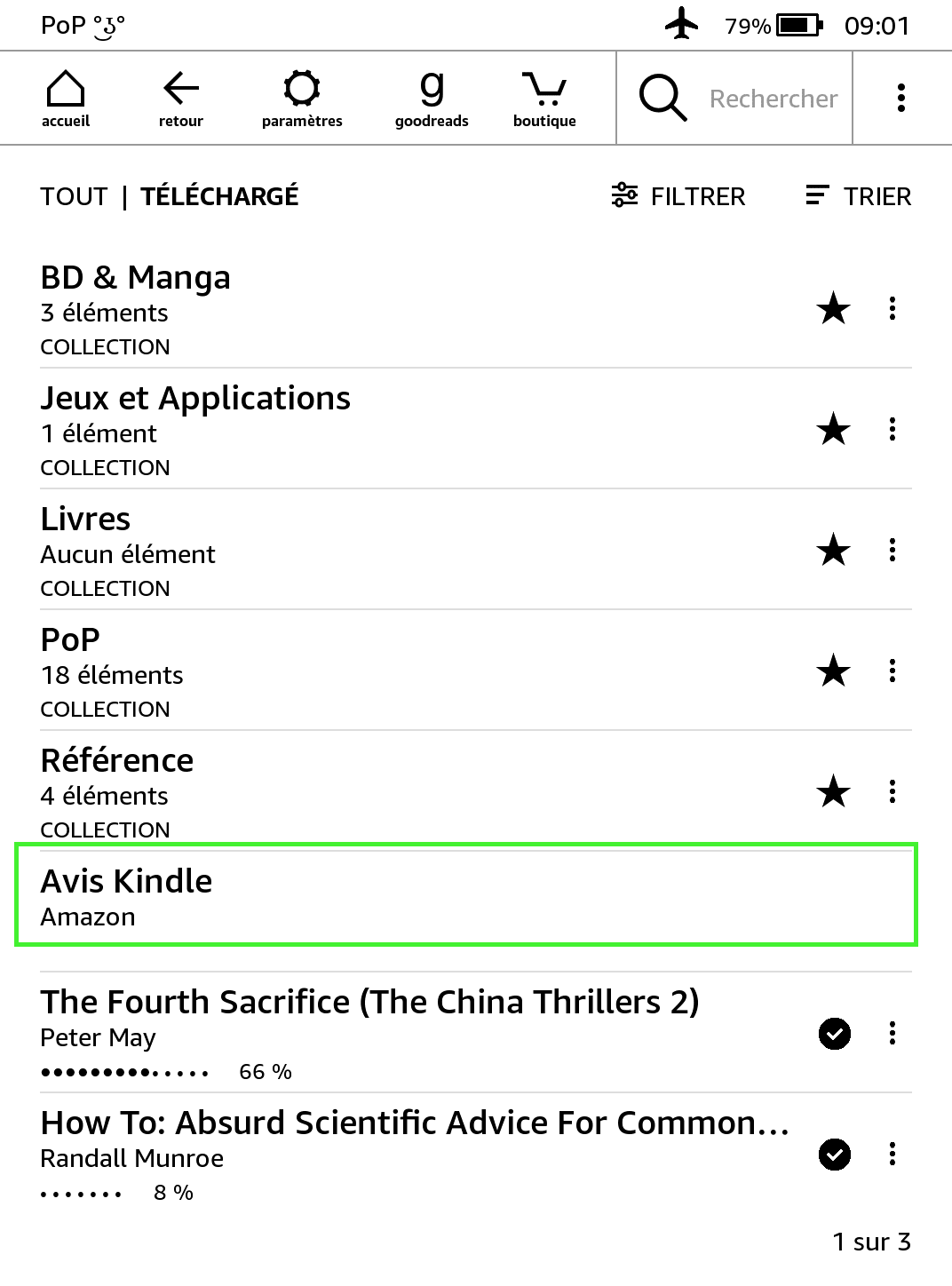

✔ Click image for larger version
Just in case I get caught next time WiFi is turned on. Thanks NiLuJe .

@hius07: That's to be expected, the bridge only creates the flag on FW 5.12.x to avoid the wide-ranging side-effects it has .
