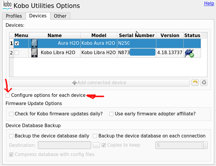

Old 11-03-2019, 02:07 PM   #1709
Quoth
Still reading
Quoth's Avatar
Posts: 15,693
Karma: 114630515
Join Date: Jun 2017
Location: Ireland
The Kobo Aura H2O original worked, the Libra not.
I was sure it had earlier!
Then I remembered I'd ticked a couple of boxes. Can't get in to untick when the libra is connected, so reconnected the H2O.
Unticked the two boxes one at a time.
It was the one pointed to with red arrow that causes the error if the Libra is detected.
No doubt someone will wonder why I ticked it in the first place. Seemed like something to tick!
So now everything working, reading annotations, no errors with Libra.
P.S. I searched for this error and found Dutch forum posts about some older version of Calibre or something.
Quoth is offline
Old 11-03-2019, 06:45 PM   #1710
davidfor
Posts: 24,905
Karma: 47303828
Location: Sydney, Australia
That option is there if you want the options further down to be device specific. If you want to check the firmware or do the backups differently for each device.
Hmm, not quite enough protection in case of no values. I'll fix it soon.
davidfor is offline
