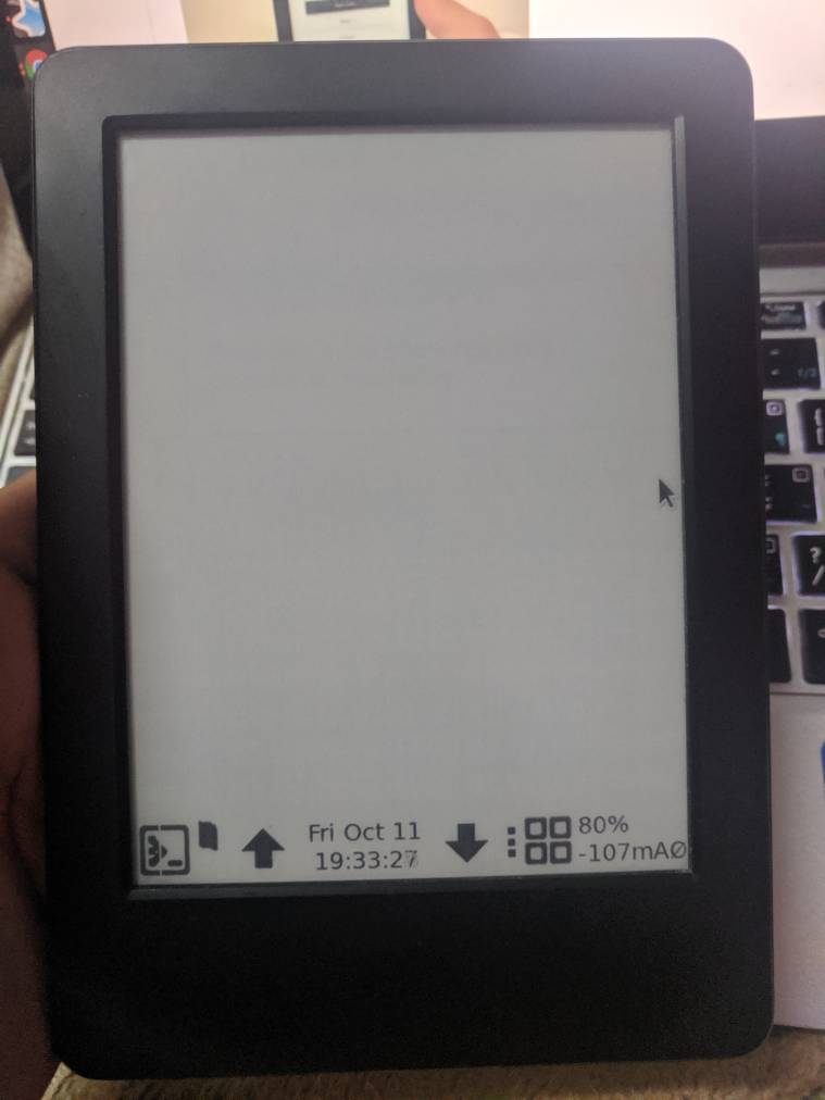

Dear @schuhumi,
After a lot of holding it off, I've recently found some time and tried this on my Kindle. It's a Kindle 7th gen (KT2) with a 160 dpi E Ink Pearl.
The interface is not at all usable, nor are programs when opened using a SSH terminal.
Any idea how to scale it down a little?Click image for larger version
