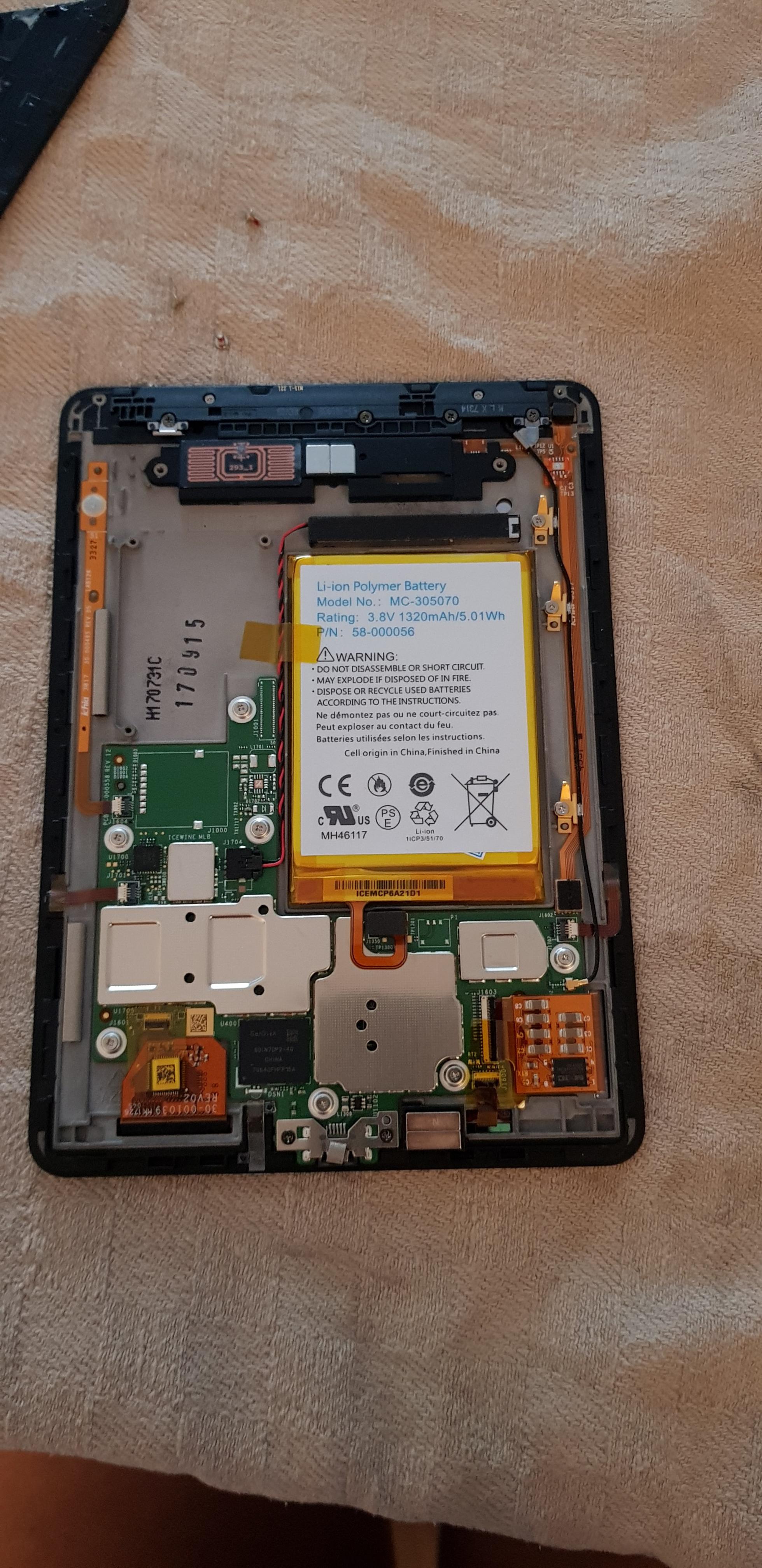

Originally Posted by 93terp View Post
From personal experience, that battery replacement is nowhere near as easy as the video makes it look....YMMV.
I've recently changed the battery of my Voyage myself, and it was as easy as in the video, so it's totally doable.
I found it incredibly difficult to separate the back piece from the Voyage as well as remove the battery. What was your trick?
At first I struggled with removing the back, but then I looked at the youtube video a few more times and decided there had to be a trick. And the trick was sliding the thing instead of just using force. And suddenly I did something right and it just came right off. (Sliding towards the bottom was what did it) I actually did it twice because I wasn't sure I connected the new battery correctly after I put it in, so I opened it up a second time.
I got this tool with the battery I ordered and it got under the battery pretty easily. It did stick, so I had to slide the plastic tool around and around until the battery came loose. Not difficult, just took some patience.
SusanReads is offline   Reply With Quote
Cool, thanks! I too received tools to remove the back and battery. Glad your experience was easier than mine!
But you did get it done, right? How are you experiencing the battery life with your new battery?
Yes, but was fairly frustrated during the process!
I'm not finding the battery life with the new battery much different than the original battery, maybe only slightly better. What about you?
I bought a refurbished Voyage so the battery was not that great (as to be expected). The new battery is about as good as the battery of a new Voyage (I've owned a new Voyage a couple of years ago, but sold it when I got a PW4, too bad I loved the Voyage more, so I ended up buying a refurbished one). But I always found the Voyage battery to last me a long time, so I'm quite happy with this new battery.
