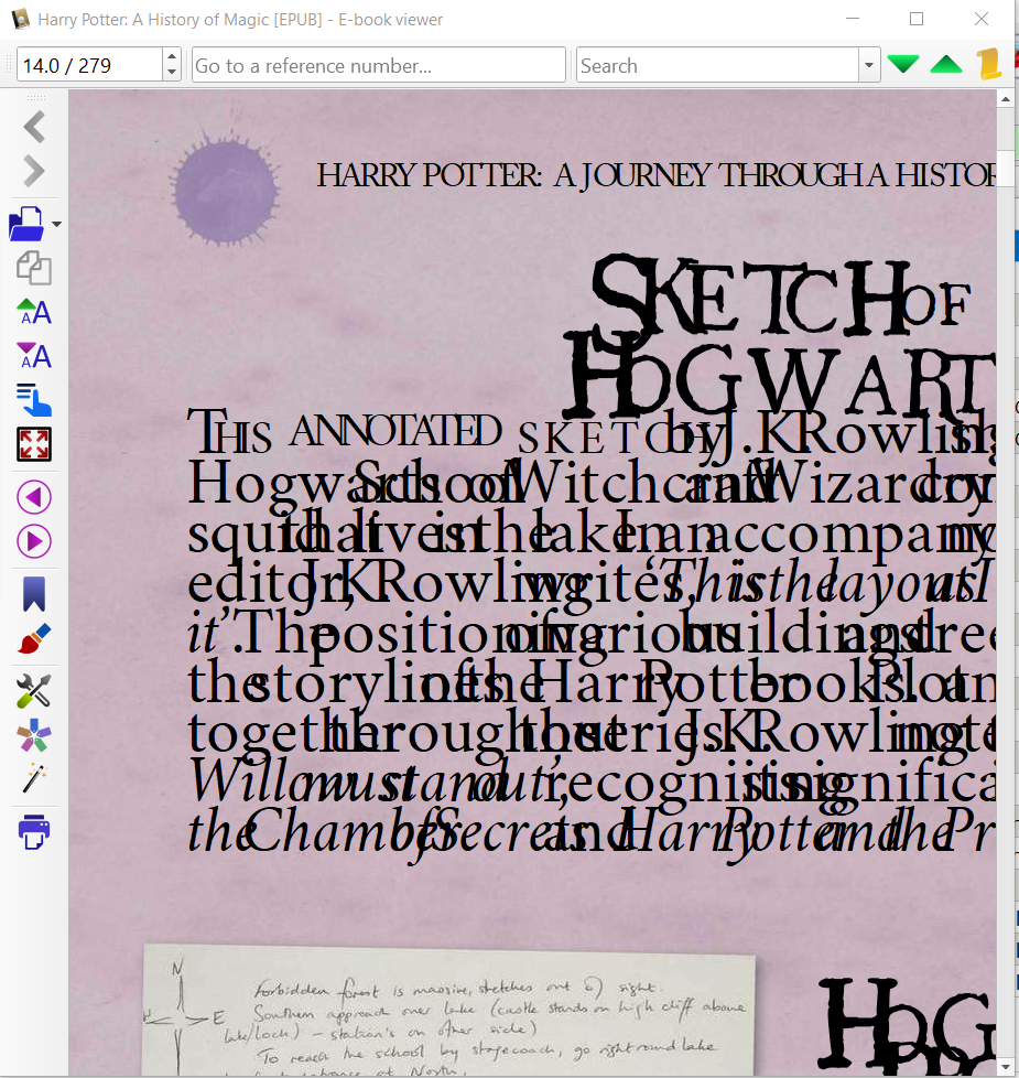

Since calibre's ebook-viewer does not currently support fixed layout, I'd recommend looking at a different program to edit/view FLO epubs. In your case, I'd suggest biting the bullet and finishing the epub in InDesign despite it's learning curve. Dreamweaver can be used, sort of, to edit epubs if you don't mind unpacking and repacking, adding bits here and there to allow editing ncx and opf files, etc.
I've attached a snip of calibre's viewer and a commercial FLO epub.

Originally Posted by Poopsey View Post
3. On one page there was a misspelled word.. When I corrected it, it stuck to the next word and I couldn't get a space between them.
A fixed-layout EPUB is generally not editable. Typically each word is placed individually at a particular position on the page by the HTML coding.
Changing the text will not cause the rest of the words to reflow to make room for the edit, so if you want to change something you have to go back and edit the original source and regenerate the fixed-layout EPUB again.
jhowell is online now   Reply With Quote
Yep, Calibre doesn't support Fixed Layout EPUBs.
You would most likely have to test on a physical device itself (iBooks on an iPad).
Yep, if you wanted to work from InDesign, that's the way that would be recommended.
Fixing the source document and reexporting from there.
InDesign's Fixed Layout EPUBs wraps each, and, every, single, word, in a span and specifies the absolute pixel position.
Back in 2015, I posted a code example out of InDesign and a few things on Fixed Layout:
https://www.mobileread.com/forums/sh...50#post3063050
Absolutely horrifying code that thing outputs.
