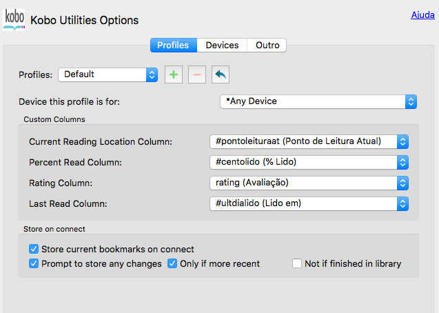

That makes me think that you haven't configured a column for the date read. If the percent read is updated, this is the most likely thing. If you have multiple profiles for different devices, make sure you are using the correct one.
Yes I have, as soon as I installed Calibre and bought my Kobo I configured it this way, configured a lot of thing, including shelves... attached some screenshots from my options.

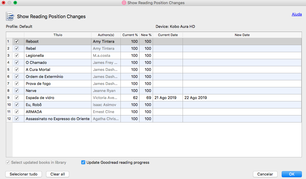

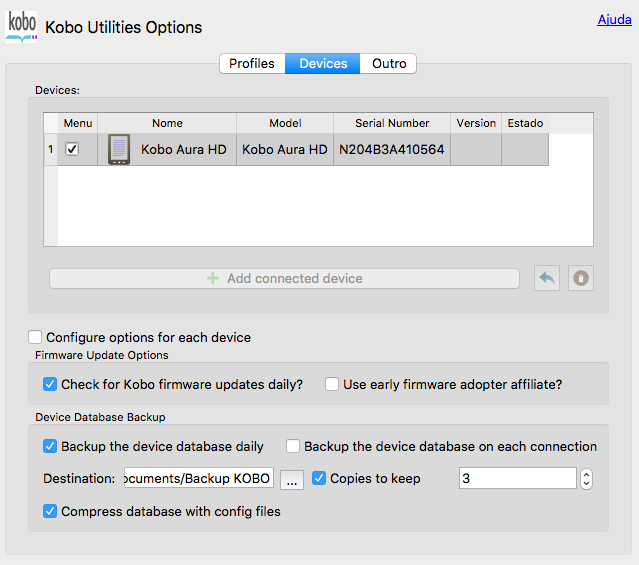

Have done it and tested today (see screenshot). The interesting is that it shows a dialog with some books finished long time ago and it claims that want to update them. I think all of them I updated LOCALLY (Calibre library) the date read metadata, but if this is the reason, them it should show a lot more books, end they are not on the list.
Searching for information about the dates on my Kobo, I incidentally touched a book I've already read and it started reading again. Marked as finished and plugged it again to sync. The same list of books were shown at the confirmation was asking to update this book as read today. So it is working. The strange thing is that it show books I did not touch anything on the device.
You have "Only if more recent" selecting in the configuration. That means it should only be fetching the reading status for books on the device that have a last read date after that in the calibre library. Which is correct for the book with a date.
There is something strange happening with the dates on the device. Can you send me the database from the device? Upload it somewhere and PM me the link. Also, is the date and time set correctly? And what language do you have the interface set to?
