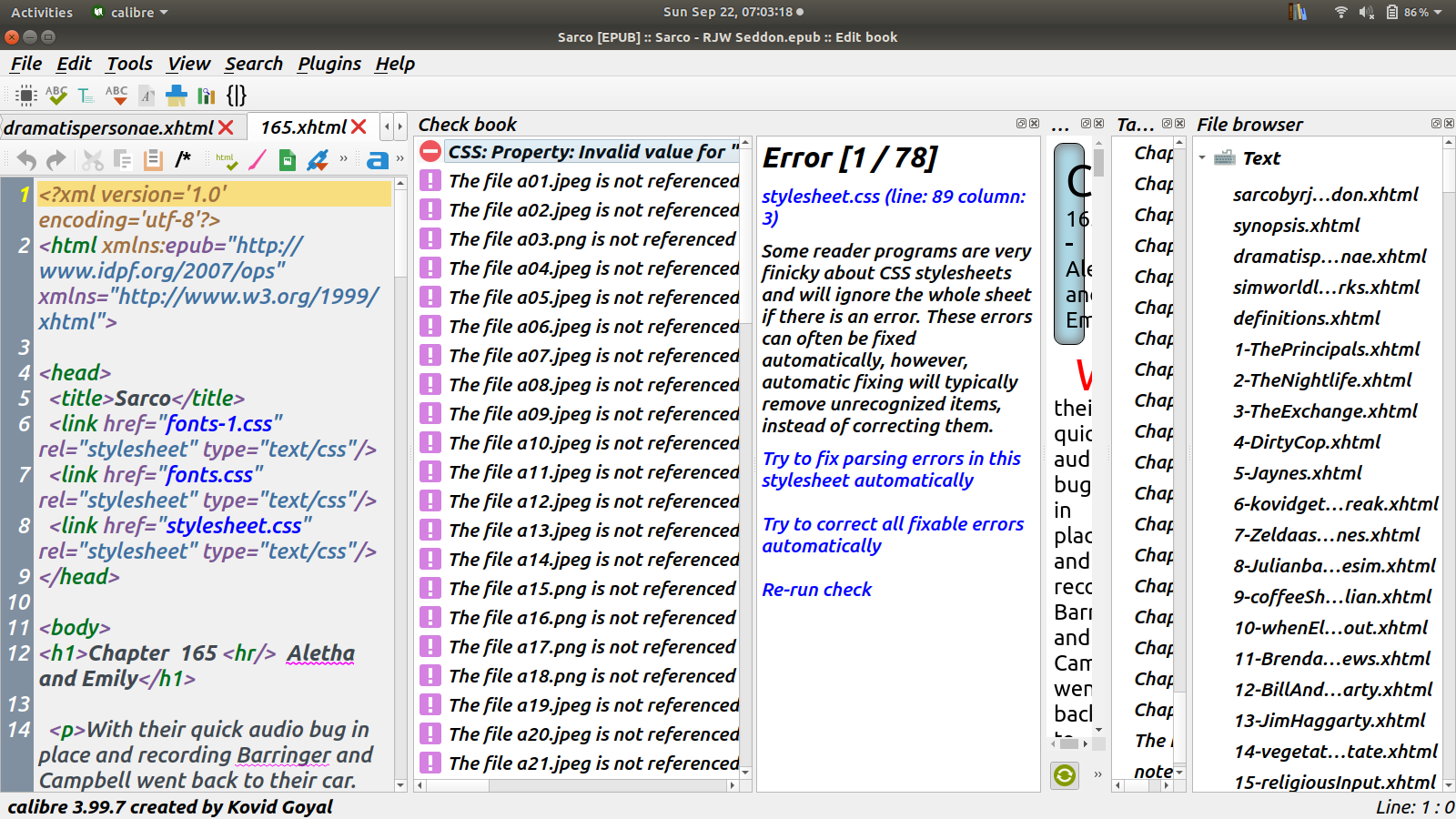

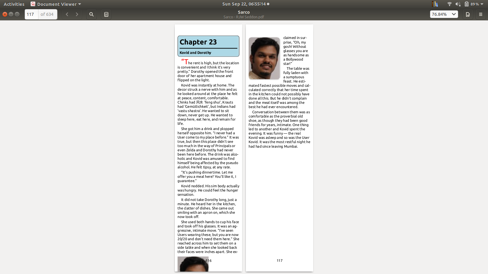

epub2pdf conversion fail in 3.99 beta
My prior epub2pdf conversions in 3.47 worked good except for sometimes cutting images horizontally at bottom of page, then showing full image again at top of next page. I wanted to test if 3.99 had fixed this and ran a epub2pdf conversion on the unaltered file. It failed. I tried calibre's self-correcting feature, but it failed again. Enclosing attachments. Best regards, Pop

@rjwse I'm going to need the epub file causing that failure as well.
kovidgoyal is offline
Old 09-22-2019, 08:41 AM   #251
Posts: 46,256
Karma: 29630732
@rjwse nevermind I found the bug it will be fixed in the next beta, in the mentime if you want to test things, just turn offthe option to add a ToC to the PDF and the rest of it should work.
