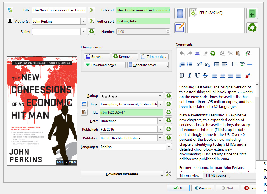

Hello,
My issue is that it takes forever for Calibre to do it's initial scan (Job). So i have disabled my device from Calibre so i'm able to use the software. However i now have created a small nightmare, as when i copy manually to my device (note 4) the file is copied as Calibre created it in it's folder. But i believe that when Calibre copied the file(s) it changes the file name ("The War" becomes "War, The"). Now i have 1600+ books that have tons of duplicates due to this issue.
In "edit metadata" i see no way to easily change the "title sort" (where i believe the problem lies) to reflect the actual title of the book and the file calibre creates in it's folders. Not really wanting to copy and paste every book with an "A" or "The" in it's title to match.
In other words, i don't really care how they are sorted, i just want them to match. So my thinking here (likely flawed!), is to start completely over and rename every book's "sort title" (manually type in to override calibre's insistence on modifying) or find an easy way to manually copy the files over so that they remain unaltered so i don't have to rename every file. Is there a setting in "edit metadata" that automatically names the files as they were meant to be (without modifying the "the") or is there a way i can list all my book files (just the epub, pdf, etc) so that i can easily copy them over to my device without having to open up each and every author folder to get to the file to copy it.
I sincerely hope this all makes sense! thanks for any help you can lend, Tom

@tomx - if you can post screen shots of the Metadata edit screen to that John Perkins book and your Preferences->Send to Device and Preferences->Save to disk settings, someone will help you figure out why you have the title_sort value (articles at end) in the file name and not the raw title value.

My goal with all this is to simply have the file name remain as calibre originally creates it (win 10). So that no matter whether i copy it manually or with calibre it is named the same. This way no matter how it gets to my device the file is named the same and then hopefully my notes will stay intact going forward no matter what device i'm using. This also makes it better if, as i do often, i edit a book's metadata (with updated info. i.e. personal review, etc.) and re-copy it to the device. Currently, if i copy it manually it stays the same, if calibre copies it, it changes.
-t
You cannot control the folder or file names within the library folder, and calibre does not provide a specific tool to copy the files with those names elsewhere - apart from pressing 'O' and copying them with your file manager.
The Save and Send templates define the file name that will be saved or sent.
Looking at your settings I cannot fathom why you would be getting {title_sort} i.e. "New . . . Hit Man The" rather than {title} - "The New . . . Hit Man" in the saved file names.
The attached screen shots show a save to disk that got the desired result.

There is tweak to control title sort vs title in save to disk templates (Preferences->Tweaks->Control formattingof title and series whenused in templates)
Old 09-16-2019, 09:34 PM   #14
Posts: 22,876
Karma: 34252730
Which defaults to 'library_order' - I probably changed that on Day 2
@tomX2 - change it to 'strictly_alphabetical'

I changed the suggested tweak, and it had the desired effect....Although, and here is where the real problem lies (if i can communicate it properly). I have no issue with where calibre places "the" or "A". In fact i don't really want to change that behavior as it means a lot of work to correct all my files (as they are mostly set that way, due to the default). My issue is that the file name gets changed when calibre copies it. In other words; "The Hidden Harbor Mystery (Book - Franklin W. Dixon.epub" (in calibre's file structure) becomes "The Hidden Harbor Mystery (Book 14) - Franklin W. Dixon.epub" when i view it on my device. I know i'm missing something, and it's entirely possible you have already explained a fix for me, but i'm still not grasping it. All this stems from my desire to have the file name remain constant so my notes are preserved. Currently if i update a book's notes, the inconsistent naming will ensure that the notes are lost. And a second file of the same book is created (with both truncated and full names).
Maybe Android has something to do with this? I am copying manually to an sd card with no special software in between (win 10). I have noticed, that this happens on the longer file names. If it is a short name, it remains the same. If it is a long file name, calibre's truncated file name is somehow converted to the full title's name (when calibre sends to device).
As i said earlier, i think at this point, i might delete all my files on my device (bite the bullet on my notes) and hand copy them over one by one. This way i should have consistent names, instead of tying to get files that calibre "sent to device" (that are mixed with files that i hand copied) to match. It will take some time, but so has figuring out this mystery.
Thanks again, all of you, t
