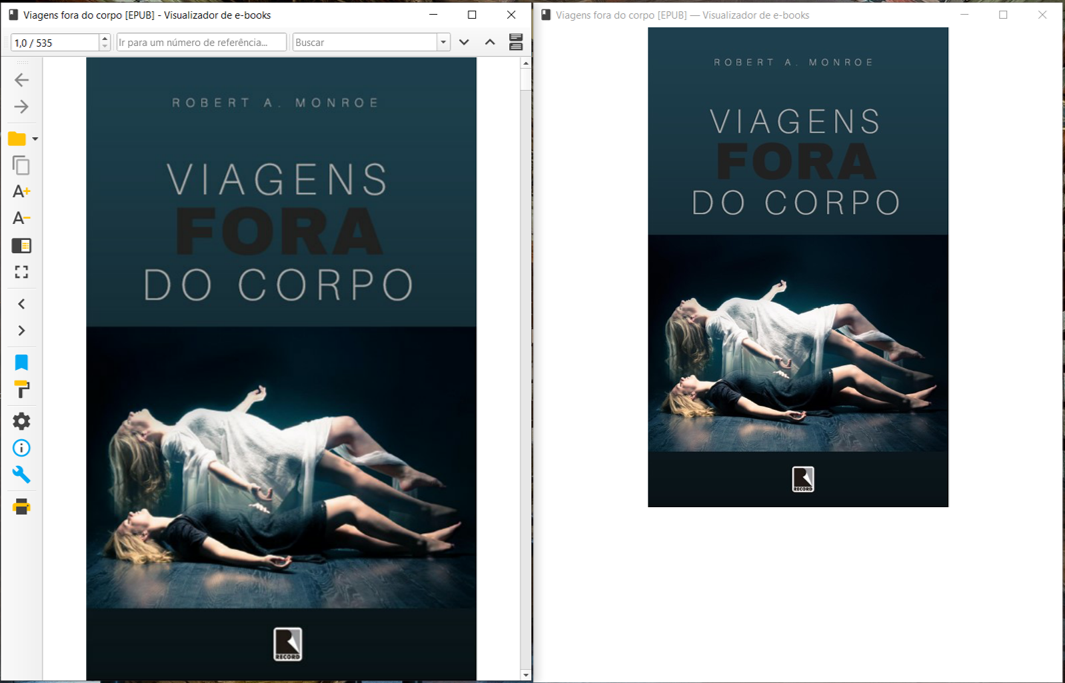

The new viewer looks great. Really clean. Kind of a chock on the first glance... but very nice.
Now, my observations:
1) I really miss the scroll bar on the right side. Maybe it could be hidden? I really miss being able to fast scan the book.
2) There are some inconsistencies with SVG covers:
This is my cover:

2.1) Looks like the cover shown on the viewer is actually the IMAGE set as cover. It does not show the XHTML cover, even if it is marked as linear on my opf. This way, I have no control on how the cover is displayed. Small images are shown centered at the top. Bigger images behaves like it has a SVG wrapper with 'preserveAspectRatio=xMidYMid meet' and fills the whole page.
(See the image attached, old viewer and new viewer rendering the same book).
2.2) On another case, my XHTML cover has a SVG with title and desc elements. This one does show on the viewer. But now I have two covers: one of the image file, other of the XHTML file. Nonetheless, the preserveAspectRatio property is still ignored on the rendered image. At least it does seem to use "xMidYMid meet" as default.

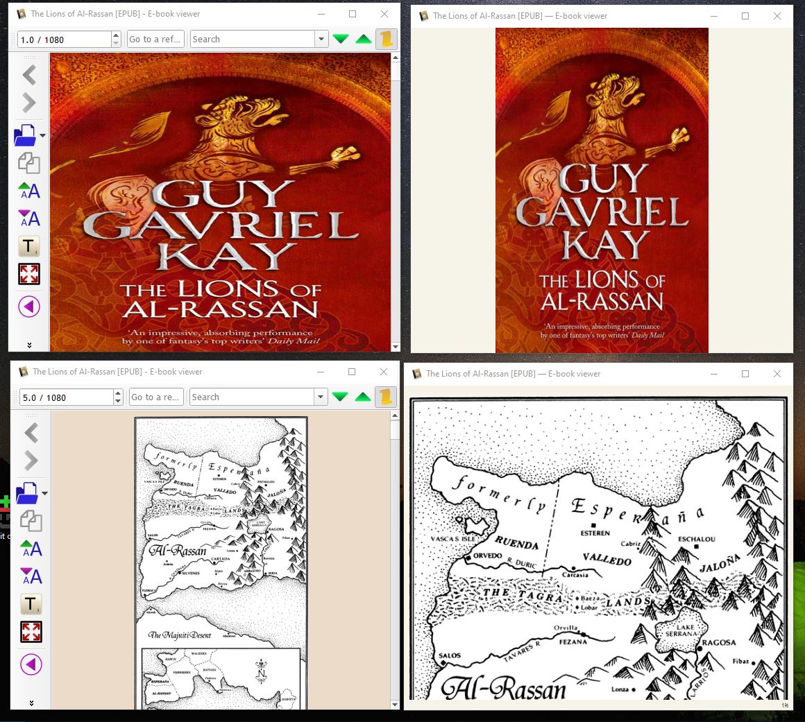

I've noticed quite a big difference between the old and new Viewer in how full page images are displayed when they are coded using <svg> tags like, or very similar to, a calibre cover.
The attached image shows what I mean. I opened the same epub 4 times in a similar size window. All 4 used Flow mode, but changing to Paged mode in the new Viewer didn't appear to change the visuals for these 2 images..
The 2 on the left are the old Viewer and the 2 on the right the new Viewer.
The top row shows the cover page - a typical calibre svg-style cover with preserveAspectRatio="none"

The bottom row shows what is supposed to be a full page map with similar svg-style code with preserveAspectRatio="xMidYMid meet" and no inline CSS in <head>.

The old Viewer seems to give a more predictable visual result. Is this "just the way QWebEngine rendering is" or is it possible to make old and new more similar?
ETA: Oops! Didn't see thiago.eec's post before posting this.

Covers are no longer displayed based on book markup they are displayed standalone, so you (the book creator) cannot control how they are displayed. The user instead has that control, at least in theory if I make a setting for it.
As for aspect ratio on normal full screen images not working, I'll have to look into that, can somebody attach a sample eub showing the problem. Will save me some time.
