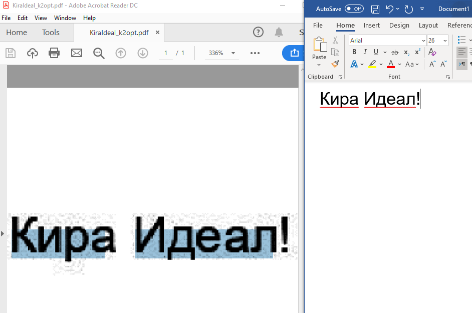

bug(non-ascii): Cyrillic symbols in generated PDF
Sorry, I can't find k2pdfopt issue tracker (one thread in BBCode forum, really?), therefore, I post detailed issue to my GitHub tracker — https://github.com/Kristinita/SashaM...eous/issues/27.
@willus, please, review this issue, when you will have a free time.
Thanks.
Thanks.
Thank you for the detailed problem report. It is very thorough. The issue, I believe, is the PDF software you use to do the copying and pasting of the OCR text. The method I use to create the OCR layer is slightly unconventional, and some software (e.g. SumatraPDF) does not copy and paste correctly, but Adobe Acrobat Reader correctly copies and pastes into MS Word. See attached screen shot.

Umesh
Nameless Being
Hello Mr. Willus Sir. Thank you for the software. If worked great for me for quite sometime, but now if I select the option of 'postprocess with ghostscript', the application crashes. This option worked fine on the day that I had earlier installed Ghostscript PostScript and PDF Interpreter. Could you list a possible solution and also could you please give a link to the precise exe file of Ghostscript that needs to be installed.
Regards,
Umesh
