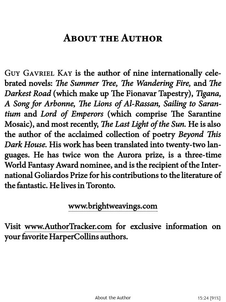

Here's a screenshot of how it looks on my Forma. You can see the 2 hyperlinks at the bottom of the page.
You can customise the style in the Replace string however you like as long as you keep it exactly the same length as the Find string, e.g. if it's too wishy-washy try dashed instead of dotted or increase the 3px.
Good luck
