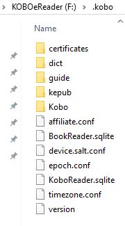

I wasn't able to locate the files you referred to.
Here's a screenshot of the directory:
Attachment 173130
I've just done another reset. No change.
The files I am referring to are put on the device as part of the firmware update process. If you do it WiFi, you won't see them as they are removed once the update is finished. If you do the setup using the Kobo desktop applicaiton, it will copy the files onto the device. You can remove them before ejecting to prevent the firmware update.
