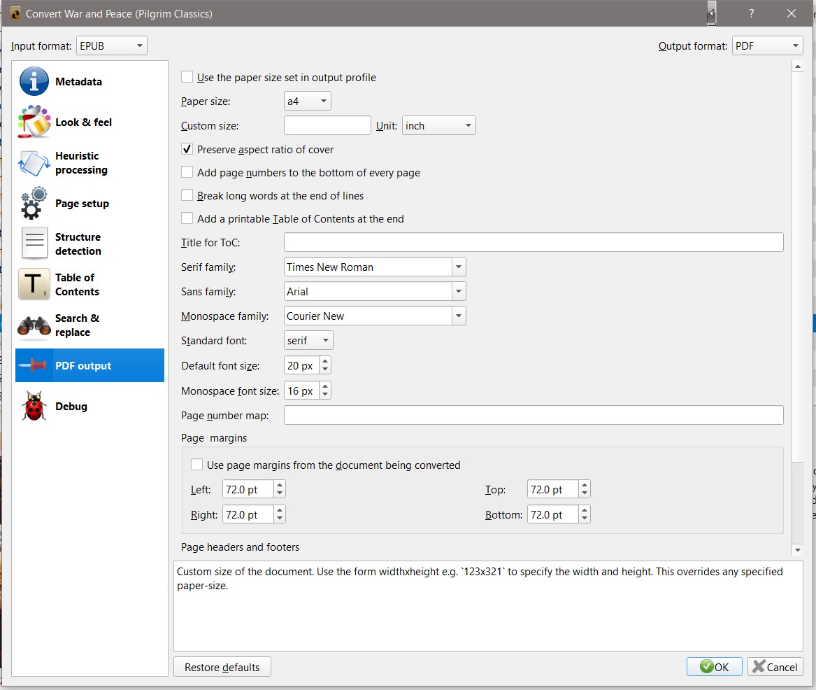

That is surprisingly effective, thank you. Do you happen to know if there is a way to add custom page sizes and not include the external TOC at the end?

'Fraid not - ask in the main calibre forum, someone's bound to know.
But a quick glance suggests you might be able to use calibre's Conversion - PDF Output feature looks like it has what you want

The Viewer Print would be a fixed version of that
