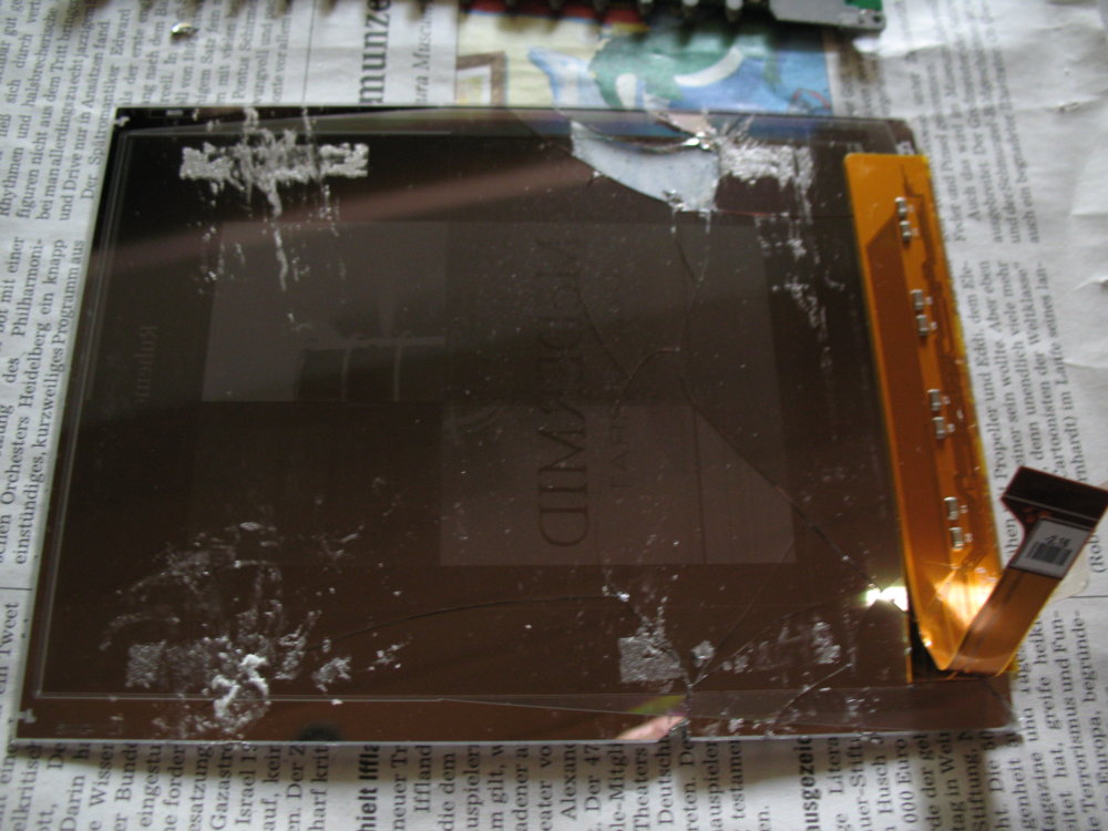

there's also some vcom setting in hwconfig but it's set to 0 I believe
the value printed on my H2O replacement display was completely different from what was in it before
The old display I don't have it anymore and it's blurry on the picture https://www.mobileread.com/forums/at...hmentid=172062 but it was -2.1x something and -1.27 on the new one https://www.mobileread.com/forums/sh...d.php?t=320264
so this is a big difference, no?
and yet it works just fine so ... I never worried about it

Originally Posted by frostschutz View Post
the value printed on my H2O replacement display was completely different from what was in it before [..] and yet it works just fine
Hm... that's interesting. Maybe it's not VCOM that's causing my issues. It it's not, though, I'm not sure what is.
