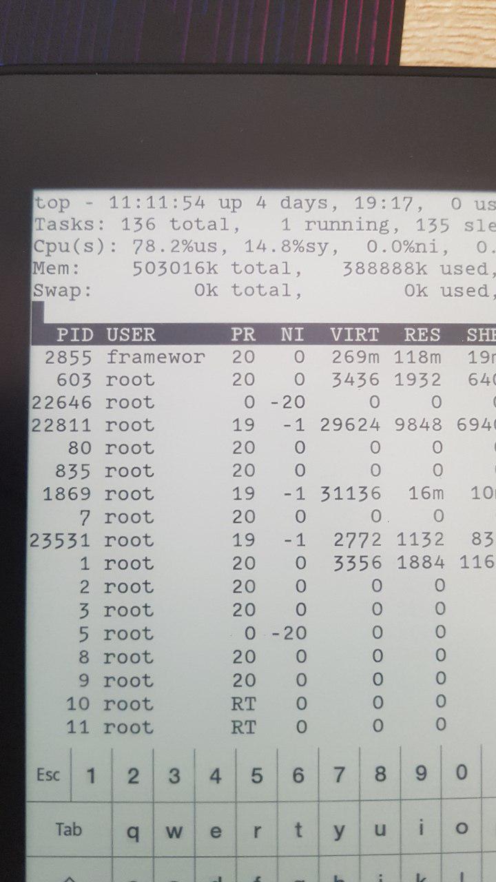

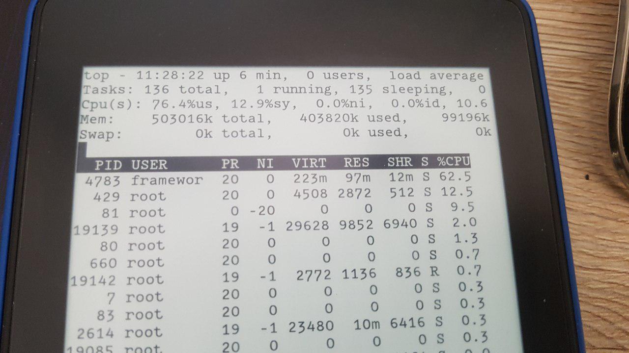

Hi guys,
Since my update to fw 5.12.1 some days ago I noticed that the battery drain of my PW4 increased dramatically. From a 2-3 weeks of work, to 3-4 days or so.
So I launched top on my kterm... it turns out the cpu is going full speed!!!
In particular, it's the framework process that is taking 80% of cpu time.
Hence the question in subject.
Anyone can contribute?
Thanks!
ID:	172694   Click image for larger version

It's basically the main backend for... basically everything that isn't hardware-related or directly book-rendering related.
You can follow the logs to see what it might actually be doing (showlog -f).

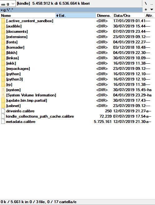

Old 07-30-2019, 01:25 PM   #12
Ruskie_it
Ruskie_it ought to be getting tired of karma fortunes by now.Ruskie_it ought to be getting tired of karma fortunes by now.Ruskie_it ought to be getting tired of karma fortunes by now.Ruskie_it ought to be getting tired of karma fortunes by now.Ruskie_it ought to be getting tired of karma fortunes by now.Ruskie_it ought to be getting tired of karma fortunes by now.Ruskie_it ought to be getting tired of karma fortunes by now.Ruskie_it ought to be getting tired of karma fortunes by now.Ruskie_it ought to be getting tired of karma fortunes by now.Ruskie_it ought to be getting tired of karma fortunes by now.Ruskie_it ought to be getting tired of karma fortunes by now.
Posts: 538
Karma: 1000000
Location: Rome, Italy
Device: Kindle PW5, Kindle PW4, Kindle 4 NT
So you can confirm that 5.12.1 does not delete update.bin.tmp.partial?
Mine is still there. I'll post again in a few minutes just to be on the safe side.
Ruskie_it is offline   Reply With Quote
Old 07-30-2019, 01:40 PM   #13
Ruskie_it
Posts: 538
Karma: 1000000
Yep, confirm. The blocking folder is still there after a good 10 minutes (I even enabled the wifi again).
PW4 with jb and fw 5.12.1
